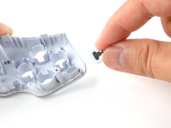

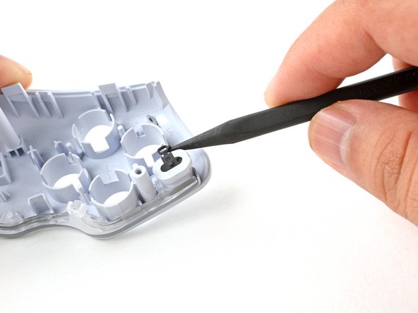

  31. PlayStation Portal Grip Shell (Right) Replacement, Remove the menu button: crwdns2935265:031crwdnd2935265:01crwdnd2935265:03crwdne2935265:0 PlayStation Portal Grip Shell (Right) Replacement, Remove the menu button: crwdns2935265:031crwdnd2935265:02crwdnd2935265:03crwdne2935265:0 PlayStation Portal Grip Shell (Right) Replacement, Remove the menu button: crwdns2935265:031crwdnd2935265:03crwdnd2935265:03crwdne2935265:0
    • Use the point of a spudger to pry up the menu button from its attachment point.
    • Remove the menu button.
    • During reassembly, use a spudger to gently press the menu button's attachment loop back onto its attachment point.
