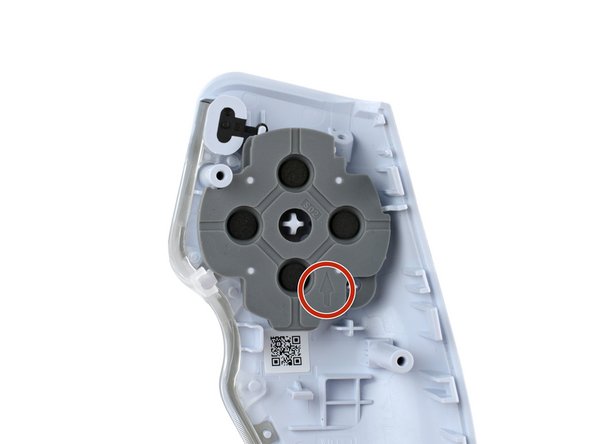

  28. PlayStation Portal D-pad Replacement, Remove the button cover: crwdns2935265:028crwdnd2935265:01crwdnd2935265:03crwdne2935265:0 PlayStation Portal D-pad Replacement, Remove the button cover: crwdns2935265:028crwdnd2935265:02crwdnd2935265:03crwdne2935265:0 PlayStation Portal D-pad Replacement, Remove the button cover: crwdns2935265:028crwdnd2935265:03crwdnd2935265:03crwdne2935265:0
    • Use your fingers to peel the gray button cover away from the grip shell and remove it.
    • During reassembly:
    • Make sure the orientation arrow on the button cover points upwards.

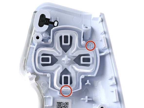

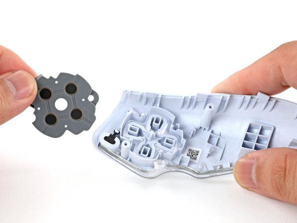

  29. PlayStation Portal D-pad Replacement, Remove the D-pad: crwdns2935265:029crwdnd2935265:01crwdnd2935265:02crwdne2935265:0 PlayStation Portal D-pad Replacement, Remove the D-pad: crwdns2935265:029crwdnd2935265:02crwdnd2935265:02crwdne2935265:0
    • Flip the grip shell over to drop out the D-pad.
    • Orient the D-pad such that the alignment tabs rest in the shell's cutouts.
