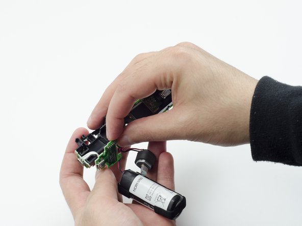

      • Carefully pinch the plastic sides of the battery slot and lift it (along with the circuit board) from the plastic shell of the move controller.

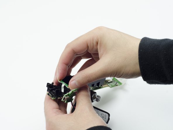

      • Using your fingers, carefully pry the square green piece beneath the battery slot free.
      • It is attached via white ribbons which need to be kept intact.

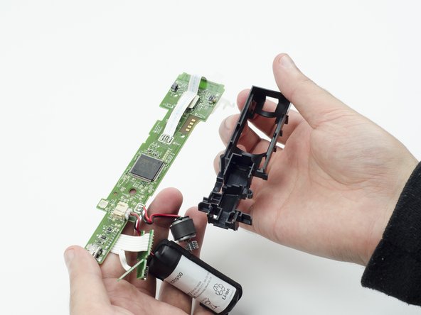

      • Follow the white ribbon attached to the part you just removed to a smaller, more rectangular piece.
      • Lift the rectangular piece from its slot to free it.

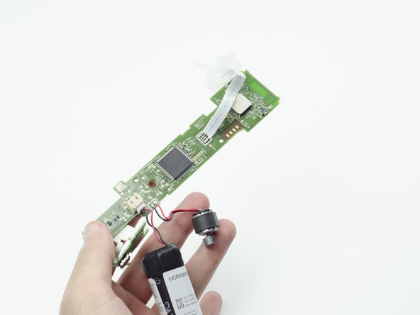

      • Carefully lift the entire circuit board from the black plastic encasing it.
      • Take extra care not to damage any of the wired components.
    1. PlayStation Move USB Port Replacement, USB Port: crwdns2935265:012crwdnd2935265:01crwdnd2935265:01crwdne2935265:0
      • At the end of the circuit board, you should see a small silver connector port (this is the USB).
      • Using a soldering iron, carefully desolder the port from the board. For help with desoldering, please reference this guide: How To Solder and Desolder Connections
      • In order to reinstall the new USB port, you must solder the new one to the board.
