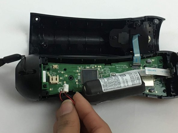

    • Once the device is opened, lift the battery out of the black plastic holder.
    • Carefully pull the battery out and ensure that it's wires are still connected to the inside.

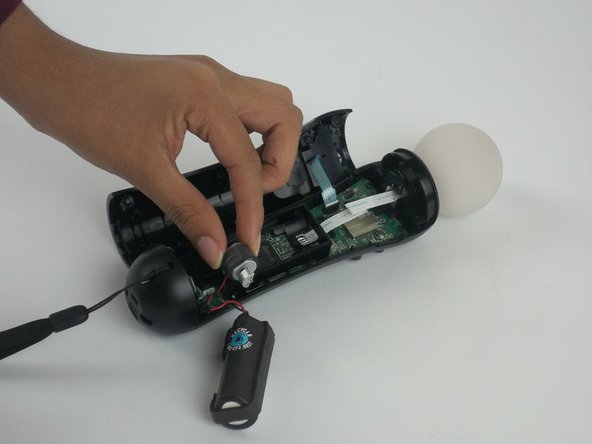

    • Using a Phillips head screwdriver, remove the 9mm screw located to the right of the battery, which is connected to the inner plastic frame.
    • Using the plastic opening tool carefully take out the grey cylindrical piece (vibrator) that is also attached to a wire.
  5. PlayStation Move Trigger Button Replacement: crwdns2935265:05crwdnd2935265:01crwdnd2935265:02crwdne2935265:0 PlayStation Move Trigger Button Replacement: crwdns2935265:05crwdnd2935265:02crwdnd2935265:02crwdne2935265:0
    • Gently pull out the small grey cylindrical piece (vibrator).
    • Removing this piece makes it easier to access the wire connection of the battery and remove it.

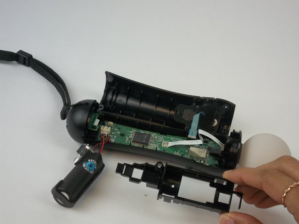

  7. PlayStation Move Trigger Button Replacement: crwdns2935265:07crwdnd2935265:01crwdnd2935265:03crwdne2935265:0 PlayStation Move Trigger Button Replacement: crwdns2935265:07crwdnd2935265:02crwdnd2935265:03crwdne2935265:0 PlayStation Move Trigger Button Replacement: crwdns2935265:07crwdnd2935265:03crwdnd2935265:03crwdne2935265:0
    • Using one hand to hold the device, and the other hand to squeeze the inner plastic frame.
    • Remove by squeezing the inner plastic frame, lift and pull it towards you.
    • While removing the frame, be extremely careful because it could damage the frame or the motherboard.

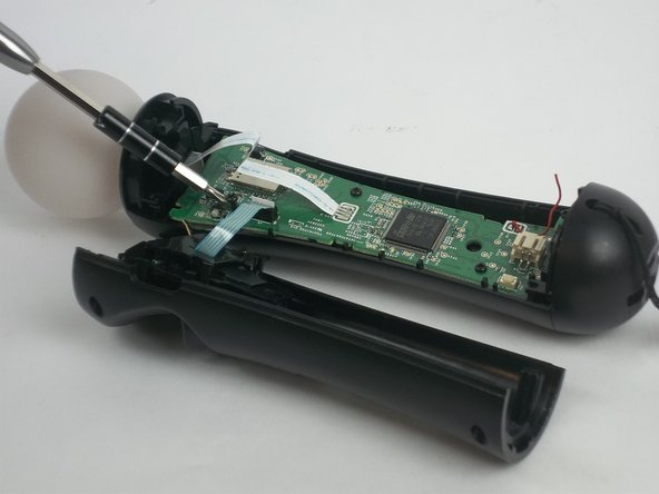

    • Remove the five 1.2 mm screws from upper portion of the controller.
    • If you are replacing the trigger button, continue to step 13.

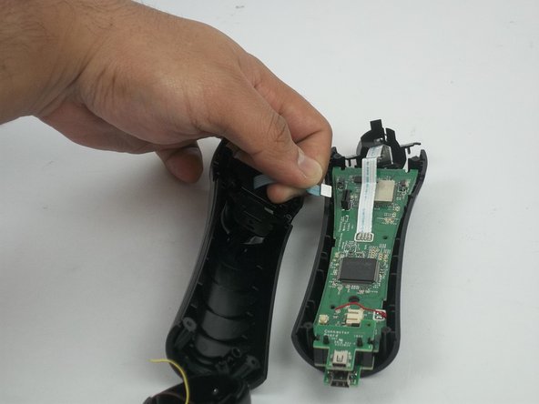

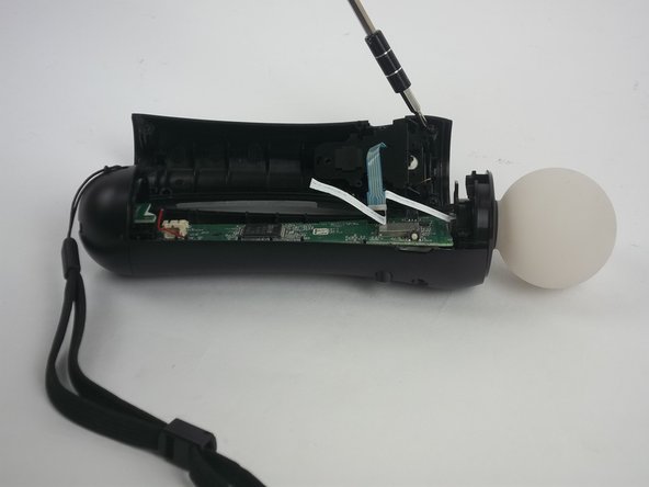

    • Cautiously remove the circular white piece at the top without removing the LED inside.

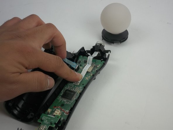

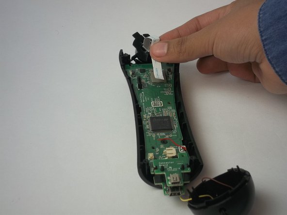

  12. PlayStation Move Trigger Button Replacement: crwdns2935265:012crwdnd2935265:01crwdnd2935265:03crwdne2935265:0 PlayStation Move Trigger Button Replacement: crwdns2935265:012crwdnd2935265:02crwdnd2935265:03crwdne2935265:0 PlayStation Move Trigger Button Replacement: crwdns2935265:012crwdnd2935265:03crwdnd2935265:03crwdne2935265:0
    • Remove the blue strip that is connected to the trigger button from the motherboard.
    • Be careful to gently detach it from the motherboard. The strip may rip if too much strength is applied.

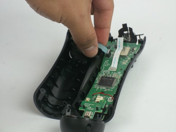

    • Remove the trigger button from the controller.
  14. PlayStation Move Trigger Button Replacement: crwdns2935265:014crwdnd2935265:01crwdnd2935265:03crwdne2935265:0 PlayStation Move Trigger Button Replacement: crwdns2935265:014crwdnd2935265:02crwdnd2935265:03crwdne2935265:0 PlayStation Move Trigger Button Replacement: crwdns2935265:014crwdnd2935265:03crwdnd2935265:03crwdne2935265:0

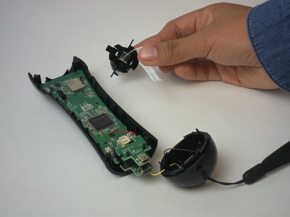

    • Remove the LED light by removing the white strip.
    • If you are replacing the LED light, continue to Step 17.
  15. PlayStation Move Trigger Button Replacement: crwdns2935265:015crwdnd2935265:01crwdnd2935265:02crwdne2935265:0 PlayStation Move Trigger Button Replacement: crwdns2935265:015crwdnd2935265:02crwdnd2935265:02crwdne2935265:0

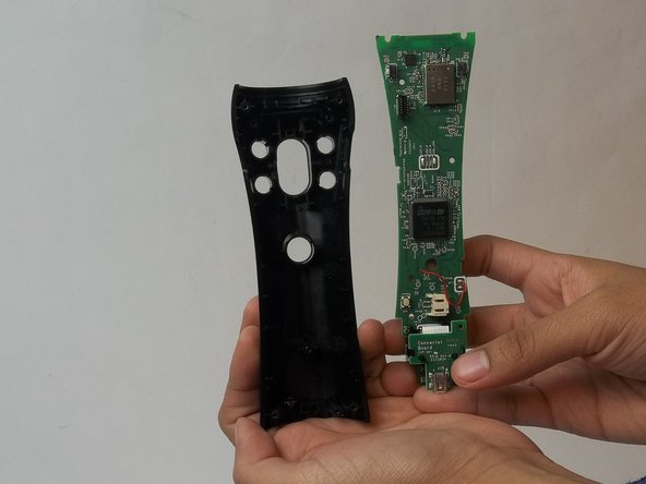

    • Remove the motherboard from the plastic case.
