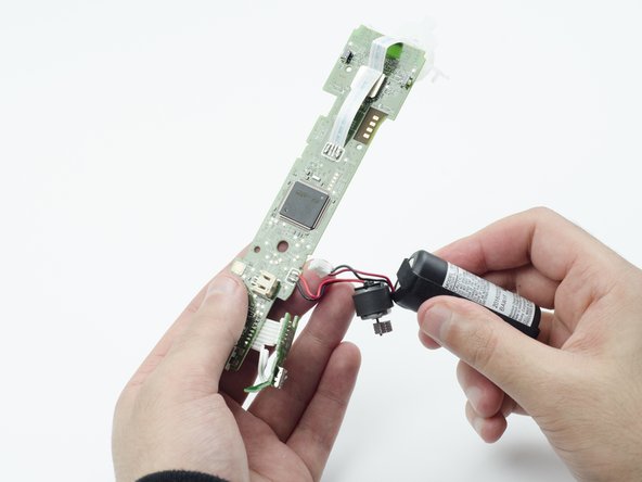

      • Carefully lift the entire circuit board from the black plastic encasing it.
      • Take extra care not to damage any of the wired components.
    1. PlayStation Move Battery Replacement, Battery: crwdns2935265:012crwdnd2935265:01crwdnd2935265:02crwdne2935265:0 PlayStation Move Battery Replacement, Battery: crwdns2935265:012crwdnd2935265:02crwdnd2935265:02crwdne2935265:0
      • Using tweezers, carefully pull the power cable from its port on the circuit board.
