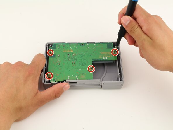

  4. PlayStation Classic Controller Port Replacement: crwdns2935265:04crwdnd2935265:01crwdnd2935265:01crwdne2935265:0
    • Unscrew the motherboard's four 6mm screws with the Phillips #00 screwdriver.
    • Be careful not to apply too much force. The motherboard is flimsy and easy to break.
    • Keep track of your screws once they are removed.
  5. PlayStation Classic Controller Port Replacement: crwdns2935265:05crwdnd2935265:01crwdnd2935265:03crwdne2935265:0 PlayStation Classic Controller Port Replacement: crwdns2935265:05crwdnd2935265:02crwdnd2935265:03crwdne2935265:0 PlayStation Classic Controller Port Replacement: crwdns2935265:05crwdnd2935265:03crwdnd2935265:03crwdne2935265:0
    • Carefully remove the motherboard from the the rest of the console using your hands or the Jimmy tool.

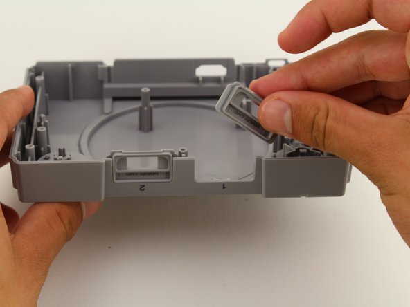

  7. PlayStation Classic Controller Port Replacement, Controller Port: crwdns2935265:07crwdnd2935265:01crwdnd2935265:02crwdne2935265:0 PlayStation Classic Controller Port Replacement, Controller Port: crwdns2935265:07crwdnd2935265:02crwdnd2935265:02crwdne2935265:0
    • Identify the damaged or faulty controller port and simply use your fingers to remove.
