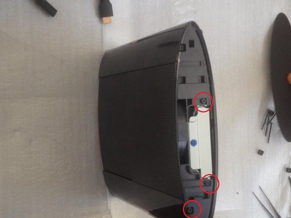

    • After removing HDD bay cover, you will see another 3 screw.
  4. PlayStation 3 Super Slim Laser Unit Replacement: crwdns2935265:04crwdnd2935265:01crwdnd2935265:03crwdne2935265:0 PlayStation 3 Super Slim Laser Unit Replacement: crwdns2935265:04crwdnd2935265:02crwdnd2935265:03crwdne2935265:0 PlayStation 3 Super Slim Laser Unit Replacement: crwdns2935265:04crwdnd2935265:03crwdnd2935265:03crwdne2935265:0

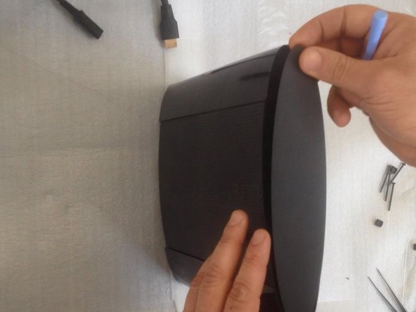

    • Push there to release and remove upper back bezel.
  5. PlayStation 3 Super Slim Laser Unit Replacement: crwdns2935265:05crwdnd2935265:01crwdnd2935265:03crwdne2935265:0 PlayStation 3 Super Slim Laser Unit Replacement: crwdns2935265:05crwdnd2935265:02crwdnd2935265:03crwdne2935265:0 PlayStation 3 Super Slim Laser Unit Replacement: crwdns2935265:05crwdnd2935265:03crwdnd2935265:03crwdne2935265:0

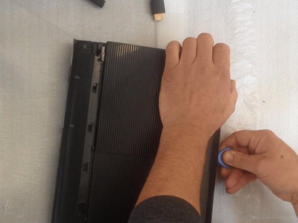

    • The upper front bezel is harder to remove.
  6. PlayStation 3 Super Slim Laser Unit Replacement: crwdns2935265:06crwdnd2935265:01crwdnd2935265:03crwdne2935265:0 PlayStation 3 Super Slim Laser Unit Replacement: crwdns2935265:06crwdnd2935265:02crwdnd2935265:03crwdne2935265:0 PlayStation 3 Super Slim Laser Unit Replacement: crwdns2935265:06crwdnd2935265:03crwdnd2935265:03crwdne2935265:0

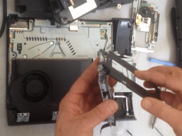

    • Disconnect two flex-cables and move the Laser Unit. Remove the two screws and the small cable and then take out the Power Supply Unit.
  8. PlayStation 3 Super Slim Laser Unit Replacement: crwdns2935265:08crwdnd2935265:01crwdnd2935265:03crwdne2935265:0 PlayStation 3 Super Slim Laser Unit Replacement: crwdns2935265:08crwdnd2935265:02crwdnd2935265:03crwdne2935265:0 PlayStation 3 Super Slim Laser Unit Replacement: crwdns2935265:08crwdnd2935265:03crwdnd2935265:03crwdne2935265:0
    • To release the laser unit disconnect this flex-cable.
    How is called this flex cable? Mine is broken so I have to buy another

  9. PlayStation 3 Super Slim Laser Unit Replacement: crwdns2935265:09crwdnd2935265:01crwdnd2935265:03crwdne2935265:0 PlayStation 3 Super Slim Laser Unit Replacement: crwdns2935265:09crwdnd2935265:02crwdnd2935265:03crwdne2935265:0 PlayStation 3 Super Slim Laser Unit Replacement: crwdns2935265:09crwdnd2935265:03crwdnd2935265:03crwdne2935265:0
    • One flex-cable, for rubbers and the metal bezel.
  10. PlayStation 3 Super Slim Laser Unit Replacement: crwdns2935265:010crwdnd2935265:01crwdnd2935265:03crwdne2935265:0 PlayStation 3 Super Slim Laser Unit Replacement: crwdns2935265:010crwdnd2935265:02crwdnd2935265:03crwdne2935265:0 PlayStation 3 Super Slim Laser Unit Replacement: crwdns2935265:010crwdnd2935265:03crwdnd2935265:03crwdne2935265:0
    • Disconnect this flex-cable and attach it to the new spare part. Let's start assembling.
