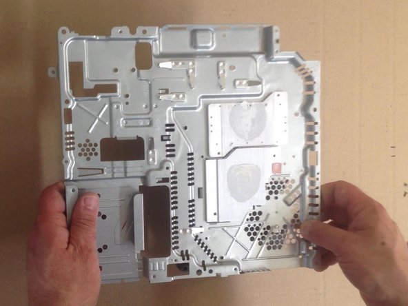

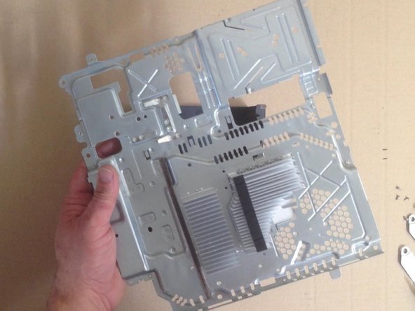

    • Remove the two heat sink clamps and bottom shield, then gently separate the motherboard off the top shield.
  3. PlayStation 3 Slim (CECH-300X) Fan system Replacement: crwdns2935265:03crwdnd2935265:01crwdnd2935265:03crwdne2935265:0 PlayStation 3 Slim (CECH-300X) Fan system Replacement: crwdns2935265:03crwdnd2935265:02crwdnd2935265:03crwdne2935265:0 PlayStation 3 Slim (CECH-300X) Fan system Replacement: crwdns2935265:03crwdnd2935265:03crwdnd2935265:03crwdne2935265:0
    • Remove the four Phillips screws and lift the top shield.

Awesome guide. Thank you so much. I did it, but now I just wonder what that white stuff was when I removed the motherboard. I think it's that thermal stuff people have been talking about and I suppose I have to replace that. I also hope that it's the fan that is what's causing my PS3 to say that it's overheating and shut off. I'm so glad you guys posted this. Great job. I rather do it myself than pay Sony an arm and a leg. Cheers!
chetacheez - crwdns2934203:0crwdne2934203:0
This is CPU / GPU thermal paste / compound. I recommend you Arctic MX-2, MX-4. It is very good and not expensive.
