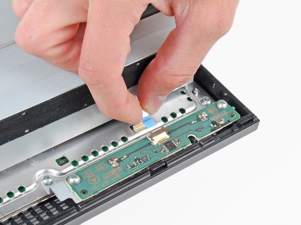

  7. PlayStation 3 Control Board Replacement, Control Board: crwdns2935265:07crwdnd2935265:01crwdnd2935265:02crwdne2935265:0 PlayStation 3 Control Board Replacement, Control Board: crwdns2935265:07crwdnd2935265:02crwdnd2935265:02crwdne2935265:0
    • Use your fingernail to flip up the retaining flap on the control board ribbon cable socket.
    • Be sure you are prying up on the retaining flap, not the socket itself.
    • Pull the control board ribbon cable out of its socket.
  8. PlayStation 3 Control Board Replacement: crwdns2935265:08crwdnd2935265:01crwdnd2935265:01crwdne2935265:0
    • Remove the two 12 mm Phillips screws securing the control board to the lower case.
  9. PlayStation 3 Control Board Replacement: crwdns2935265:09crwdnd2935265:01crwdnd2935265:01crwdne2935265:0
    • Remove the control board from the lower case.
