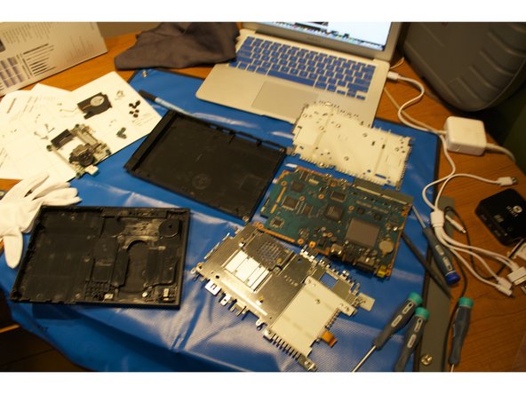

  1. PlayStation 2 Slimline Teardown, Let's get started: crwdns2935265:01crwdnd2935265:01crwdnd2935265:01crwdne2935265:0
    • Start with the console upside down.
  2. PlayStation 2 Slimline Teardown: crwdns2935265:02crwdnd2935265:01crwdnd2935265:02crwdne2935265:0 PlayStation 2 Slimline Teardown: crwdns2935265:02crwdnd2935265:02crwdnd2935265:02crwdne2935265:0
    • Remove the six screw covers and place on project mat.
    • Remove the six 4.0 mm screws on the base of the PS2. (Place on your project mat.)
  3. PlayStation 2 Slimline Teardown: crwdns2935265:03crwdnd2935265:01crwdnd2935265:03crwdne2935265:0 PlayStation 2 Slimline Teardown: crwdns2935265:03crwdnd2935265:02crwdnd2935265:03crwdne2935265:0 PlayStation 2 Slimline Teardown: crwdns2935265:03crwdnd2935265:03crwdnd2935265:03crwdne2935265:0
    • Separate the bottom of PS2 from the top. Place to the side.
  4. PlayStation 2 Slimline Teardown: crwdns2935265:04crwdnd2935265:01crwdnd2935265:01crwdne2935265:0

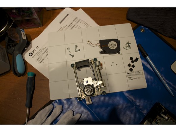

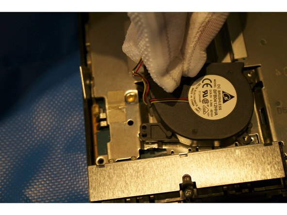

  6. PlayStation 2 Slimline Teardown: crwdns2935265:06crwdnd2935265:01crwdnd2935265:03crwdne2935265:0 PlayStation 2 Slimline Teardown: crwdns2935265:06crwdnd2935265:02crwdnd2935265:03crwdne2935265:0 PlayStation 2 Slimline Teardown: crwdns2935265:06crwdnd2935265:03crwdnd2935265:03crwdne2935265:0
    • Fan has red, black, and yellow wires under hold down tape. Remove the tape gently.
    • Release the connector gently from motherboard.
    • There three 1.6 mm screws around the base of the fan. Place both fan and screws on your project mat.
  7. PlayStation 2 Slimline Teardown: crwdns2935265:07crwdnd2935265:01crwdnd2935265:03crwdne2935265:0 PlayStation 2 Slimline Teardown: crwdns2935265:07crwdnd2935265:02crwdnd2935265:03crwdne2935265:0 PlayStation 2 Slimline Teardown: crwdns2935265:07crwdnd2935265:03crwdnd2935265:03crwdne2935265:0
    • Optical drive on the motherboard
    • There are four 4.0 mm screws holding the optical drive.
    • Remove the four screws and place the optical drive with it's screws on your project mat.

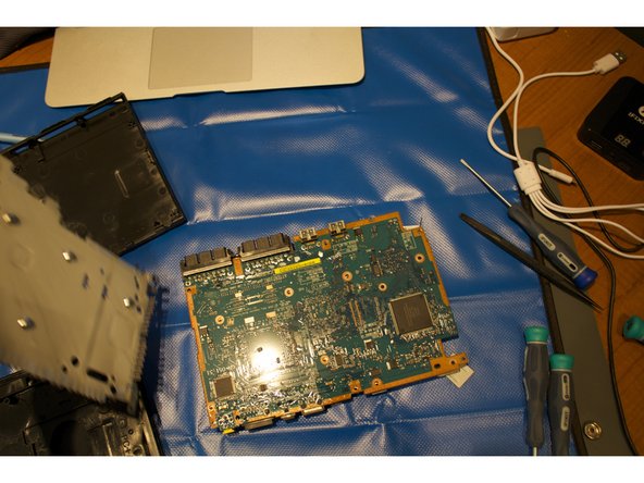

  11. PlayStation 2 Slimline Teardown: crwdns2935265:011crwdnd2935265:01crwdnd2935265:01crwdne2935265:0
    • Flip the motherboard over and remove the five screws of the second metal casing.
    • Place screws on project mat and casing to the side,
  12. PlayStation 2 Slimline Teardown: crwdns2935265:012crwdnd2935265:01crwdnd2935265:02crwdne2935265:0 PlayStation 2 Slimline Teardown: crwdns2935265:012crwdnd2935265:02crwdnd2935265:02crwdne2935265:0
    • Motherboard of PS2
    • Thank you for reading through this PS2 tear down. I hope this was helpful,

Easy there Cricket, kempc8 is (partly) right about the clock battery. There is no clock battery to disconnect in step 4, that is correct. But there is one in step 12 in a bracket, that is correct too. The reason kempc8 mentioned there is because there are other types of the PS2 slimline which do have a clock battery to remove in step 4 (seen in step 3 of this teardown)
So there is no need to call the teardown stupid, it’s well written imho.
