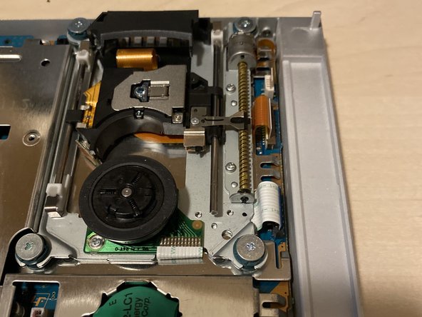

  5. PlayStation 2 Slimline SPU-3170 Laser Replacement, Remove screws and white tab: crwdns2935265:05crwdnd2935265:01crwdnd2935265:03crwdne2935265:0 PlayStation 2 Slimline SPU-3170 Laser Replacement, Remove screws and white tab: crwdns2935265:05crwdnd2935265:02crwdnd2935265:03crwdne2935265:0 PlayStation 2 Slimline SPU-3170 Laser Replacement, Remove screws and white tab: crwdns2935265:05crwdnd2935265:03crwdnd2935265:03crwdne2935265:0
    • Remove the 2 philips screws, marked in red.
    • Remove the white plastic slider holder.
    • Picture 3 shows how it should be done.
  6. PlayStation 2 Slimline SPU-3170 Laser Replacement, Remove slider: crwdns2935265:06crwdnd2935265:01crwdnd2935265:01crwdne2935265:0
    • Remove the slider as shown in the picture. You could do this with your fingers, otherwise take tweezers to remove it.

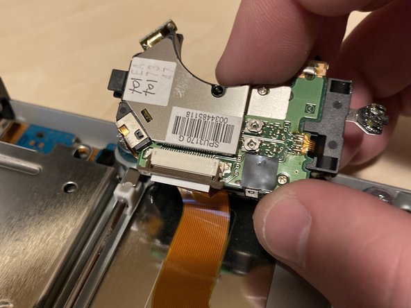

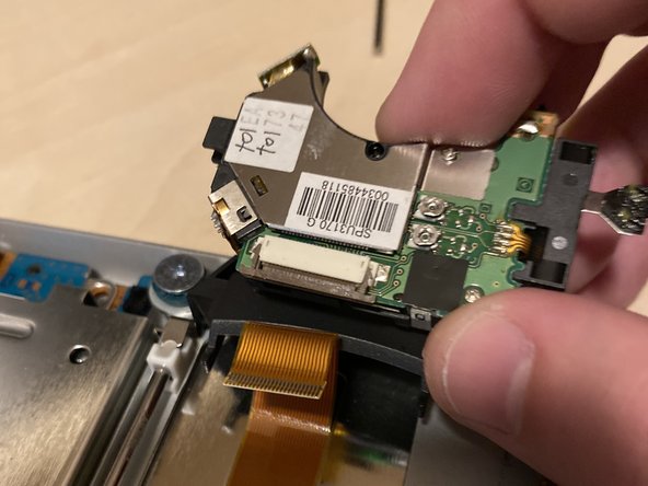

  7. PlayStation 2 Slimline SPU-3170 Laser Replacement, Disconnect the laser: crwdns2935265:07crwdnd2935265:01crwdnd2935265:03crwdne2935265:0 PlayStation 2 Slimline SPU-3170 Laser Replacement, Disconnect the laser: crwdns2935265:07crwdnd2935265:02crwdnd2935265:03crwdne2935265:0 PlayStation 2 Slimline SPU-3170 Laser Replacement, Disconnect the laser: crwdns2935265:07crwdnd2935265:03crwdnd2935265:03crwdne2935265:0
    • Do not remove the laser yet!
    • Take the laser out of the rail and rotate it.
    • Open up the connector by both sides with your fingernail or spudger. Be EXTREME carefull here, as it can break easily! (if the laser is broken, it won't matter, you can even practice on the broken laser).
    • Take the ribbon cable out, it should come out with ease.

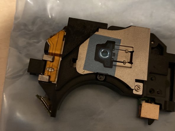

  10. PlayStation 2 Slimline SPU-3170 Laser Replacement, Laser assembly: crwdns2935265:010crwdnd2935265:01crwdnd2935265:01crwdne2935265:0
    • Remove the blue sticker from the laser (if it has one). Put the laser back in and all other removed components (follow guide in reverse order). When you've put everything back, it should look like the provided picture.
