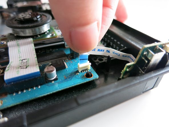

  7. PlayStation 2 Slimline SCPH-900xx Sensor Phalanx Replacement, Sensor Phalanx: crwdns2935265:07crwdnd2935265:01crwdnd2935265:02crwdne2935265:0 PlayStation 2 Slimline SCPH-900xx Sensor Phalanx Replacement, Sensor Phalanx: crwdns2935265:07crwdnd2935265:02crwdnd2935265:02crwdne2935265:0
    • Pull the ribbon cable straight out from the socket.
    • To reinstall the cable, hold it near the end and push it straight into the connector, being careful not to kink the cable. If you can, apply the force to the plastic reinforcement rather than the cable itself.
    • Lift the phalanx up and out of the PS2.
