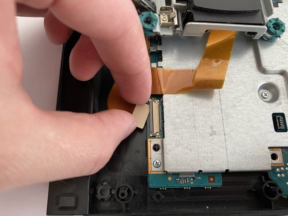

  7. PlayStation 2 Slimline SCPH-900xx Optical Drive Replacement, Optical Drive: crwdns2935265:07crwdnd2935265:01crwdnd2935265:01crwdne2935265:0
    • Pull the two ribbon cables straight out from their sockets.
    • To reinstall the cables, hold it near the end and push it straight into the connector, being careful not to kink the cable. If you can, apply the force to the plastic reinforcement rather than the cable itself.

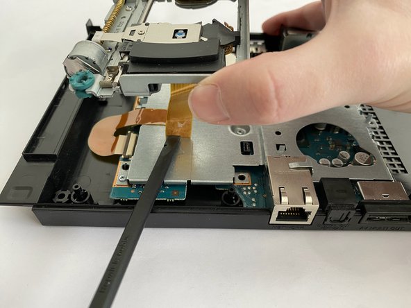

  8. PlayStation 2 Slimline SCPH-900xx Optical Drive Replacement: crwdns2935265:08crwdnd2935265:01crwdnd2935265:02crwdne2935265:0 PlayStation 2 Slimline SCPH-900xx Optical Drive Replacement: crwdns2935265:08crwdnd2935265:02crwdnd2935265:02crwdne2935265:0
    • Turn around the PS2 by 180 degrees.
    • Lift the optical drive up from its four mountings.
    • Remove the glued ribbon cable from the EMI shield using a spudger and some isopropyl alcohol.
  9. PlayStation 2 Slimline SCPH-900xx Optical Drive Replacement: crwdns2935265:09crwdnd2935265:01crwdnd2935265:02crwdne2935265:0 PlayStation 2 Slimline SCPH-900xx Optical Drive Replacement: crwdns2935265:09crwdnd2935265:02crwdnd2935265:02crwdne2935265:0
    • Pull the ribbon cable straight out from the socket.
    • To reinstall the cable, hold it near the end and push it straight into the connector, being careful not to kink the cable. If you can, apply the force to the plastic reinforcement rather than the cable itself.
    • Finally remove the optical drive from the PS2.
