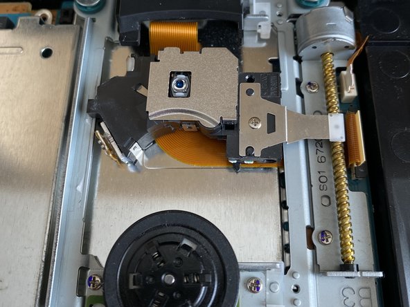

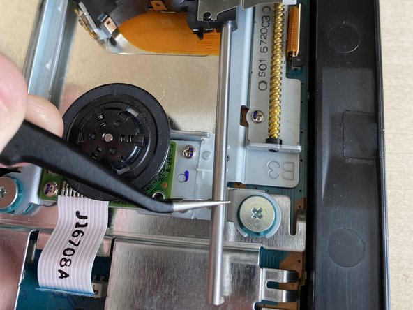

  6. PlayStation 2 Slimline PVR-802W Laser Replacement, Remove silver rail: crwdns2935265:06crwdnd2935265:01crwdnd2935265:03crwdne2935265:0 PlayStation 2 Slimline PVR-802W Laser Replacement, Remove silver rail: crwdns2935265:06crwdnd2935265:02crwdnd2935265:03crwdne2935265:0 PlayStation 2 Slimline PVR-802W Laser Replacement, Remove silver rail: crwdns2935265:06crwdnd2935265:03crwdnd2935265:03crwdne2935265:0
    • If you got the same results as in the 1st photo, then proceed.
    • Take the silver rail and push it out *carefully* from the track.
    • Take the silver rail with your tweezers and pull it towards yourself to take it out. Be carefull, as it still attached to the laser, just guide it slowly towards yourself.

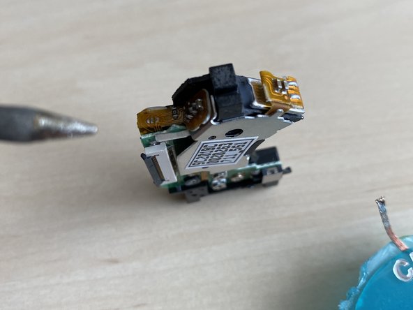

  8. PlayStation 2 Slimline PVR-802W Laser Replacement, Desoldering the anti-static security: crwdns2935265:08crwdnd2935265:01crwdnd2935265:03crwdne2935265:0 PlayStation 2 Slimline PVR-802W Laser Replacement, Desoldering the anti-static security: crwdns2935265:08crwdnd2935265:02crwdnd2935265:03crwdne2935265:0 PlayStation 2 Slimline PVR-802W Laser Replacement, Desoldering the anti-static security: crwdns2935265:08crwdnd2935265:03crwdnd2935265:03crwdne2935265:0
    • It's important to remove the anti-static security, otherwise it won't work! Some lasers come without the anti-static security.
    • You need a soldering station to DESOLDER the anti-static (if it's there), without de-soldering it, the laser could be busted!!
    • Remove the anti-static security. Use some copper wick to remove the solder.
    • When it looks like in the 3rd photo, you are good to.

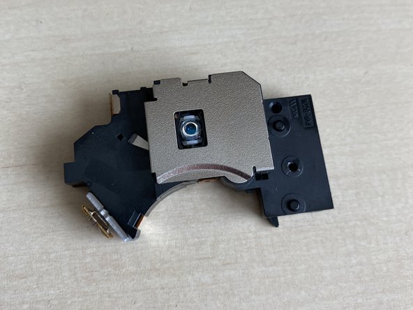

  9. PlayStation 2 Slimline PVR-802W Laser Replacement, Transfer holder: crwdns2935265:09crwdnd2935265:01crwdnd2935265:03crwdne2935265:0 PlayStation 2 Slimline PVR-802W Laser Replacement, Transfer holder: crwdns2935265:09crwdnd2935265:02crwdnd2935265:03crwdne2935265:0 PlayStation 2 Slimline PVR-802W Laser Replacement, Transfer holder: crwdns2935265:09crwdnd2935265:03crwdnd2935265:03crwdne2935265:0
    • Remove the single philips screw.
    • Transfer the holder to the new laser and fasten it again with the philips screw.
