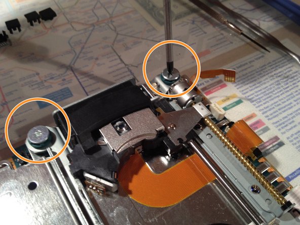

    • Remove the rubber feet on two of the screw covers on the bottom of the console.
    • Remove the screw covers and the screws themselves.
    • Caution: One of the screws is underneath the "Do not void" seal
  2. PlayStation 2 Slimline Optical Drive Replacement: crwdns2935265:02crwdnd2935265:01crwdnd2935265:02crwdne2935265:0 PlayStation 2 Slimline Optical Drive Replacement: crwdns2935265:02crwdnd2935265:02crwdnd2935265:02crwdne2935265:0
    • If all screws are removed.
    • Use a metal spunger to open the chassis
  3. PlayStation 2 Slimline Optical Drive Replacement: crwdns2935265:03crwdnd2935265:01crwdnd2935265:03crwdne2935265:0 PlayStation 2 Slimline Optical Drive Replacement: crwdns2935265:03crwdnd2935265:02crwdnd2935265:03crwdne2935265:0 PlayStation 2 Slimline Optical Drive Replacement: crwdns2935265:03crwdnd2935265:03crwdnd2935265:03crwdne2935265:0
    • Slip the three cables out of the sockets.
    • Use a PH01 screwdriver to remove the four screws securing the optical drive
    • Lift up the optical drive and remove the duct tape under the flex cable.
    • Now the optical drive is free and ready for replacement
