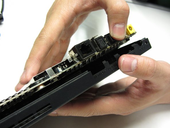

    • Gently lift and remove the motherboard and chassis from the outer shell.

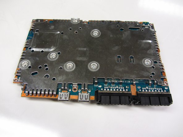

  22. PlayStation 2 Slimline Motherboard Replacement: crwdns2935265:022crwdnd2935265:01crwdnd2935265:03crwdne2935265:0 PlayStation 2 Slimline Motherboard Replacement: crwdns2935265:022crwdnd2935265:02crwdnd2935265:03crwdne2935265:0 PlayStation 2 Slimline Motherboard Replacement: crwdns2935265:022crwdnd2935265:03crwdnd2935265:03crwdne2935265:0
    • There are a total of five 1.6 mm screws which mount the metal chassis to the motherboard.
    • Remove the screw on top and the four screws on the bottom with a #1 Phillips screwdriver.
  23. PlayStation 2 Slimline Motherboard Replacement: crwdns2935265:023crwdnd2935265:01crwdnd2935265:03crwdne2935265:0 PlayStation 2 Slimline Motherboard Replacement: crwdns2935265:023crwdnd2935265:02crwdnd2935265:03crwdne2935265:0 PlayStation 2 Slimline Motherboard Replacement: crwdns2935265:023crwdnd2935265:03crwdnd2935265:03crwdne2935265:0
    • Gently separate the two metal plates from the motherboard.
