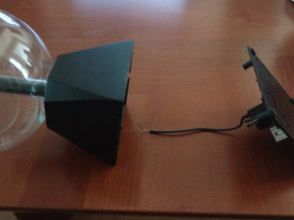

  2. Plasma Ball Teardown, Unscrew The Base: crwdns2935265:02crwdnd2935265:01crwdnd2935265:03crwdne2935265:0 Plasma Ball Teardown, Unscrew The Base: crwdns2935265:02crwdnd2935265:02crwdnd2935265:03crwdne2935265:0 Plasma Ball Teardown, Unscrew The Base: crwdns2935265:02crwdnd2935265:03crwdnd2935265:03crwdne2935265:0
    • Flip over the plasma ball ( Be careful if putting on a table, its glass its easily broken)
    • Unscrew the 4 screws, one in each corner of the mechanism.
  3. Plasma Ball Teardown, Pull the Base  Apart: crwdns2935265:03crwdnd2935265:01crwdnd2935265:03crwdne2935265:0 Plasma Ball Teardown, Pull the Base  Apart: crwdns2935265:03crwdnd2935265:02crwdnd2935265:03crwdne2935265:0 Plasma Ball Teardown, Pull the Base  Apart: crwdns2935265:03crwdnd2935265:03crwdnd2935265:03crwdne2935265:0
    • Carefully pull apart the base from the main body,
    • Now we have the base and the main panel.

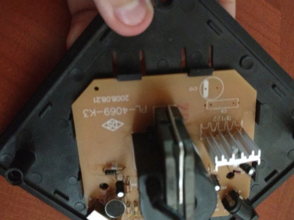

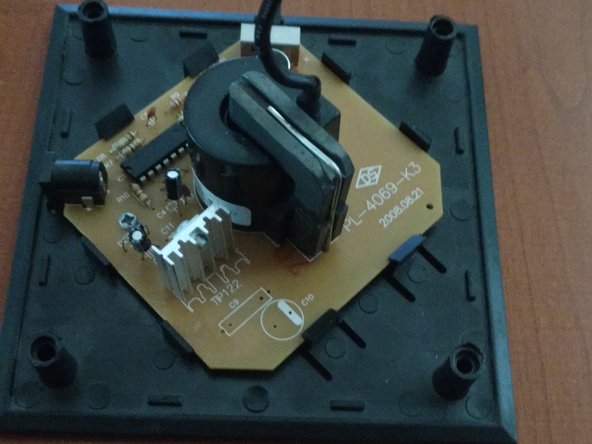

  4. Plasma Ball Teardown, Unscrew The Main Panel: crwdns2935265:04crwdnd2935265:01crwdnd2935265:03crwdne2935265:0 Plasma Ball Teardown, Unscrew The Main Panel: crwdns2935265:04crwdnd2935265:02crwdnd2935265:03crwdne2935265:0 Plasma Ball Teardown, Unscrew The Main Panel: crwdns2935265:04crwdnd2935265:03crwdnd2935265:03crwdne2935265:0
    • Unscrew the two screws that hold the base to the control center.
  5. Plasma Ball Teardown, Pop Out The Main Panel: crwdns2935265:05crwdnd2935265:01crwdnd2935265:02crwdne2935265:0 Plasma Ball Teardown, Pop Out The Main Panel: crwdns2935265:05crwdnd2935265:02crwdnd2935265:02crwdne2935265:0
    • Next pop out the control center by pushing on these two plastic holders.
  6. Plasma Ball Teardown, Remove The Main Panel: crwdns2935265:06crwdnd2935265:01crwdnd2935265:03crwdne2935265:0 Plasma Ball Teardown, Remove The Main Panel: crwdns2935265:06crwdnd2935265:02crwdnd2935265:03crwdne2935265:0 Plasma Ball Teardown, Remove The Main Panel: crwdns2935265:06crwdnd2935265:03crwdnd2935265:03crwdne2935265:0
    • Pull the control center off the base and you are done with the teardown
    • To rebuild the Plasma Ball do all the steps in reverse order.

Interesting teardown! Although, it might be noted that care should be taken when handling the circuit board, especially around the flyback transformer (big black cylinder), as plasma balls typically operate on high voltages and may pose a shock hazard.
