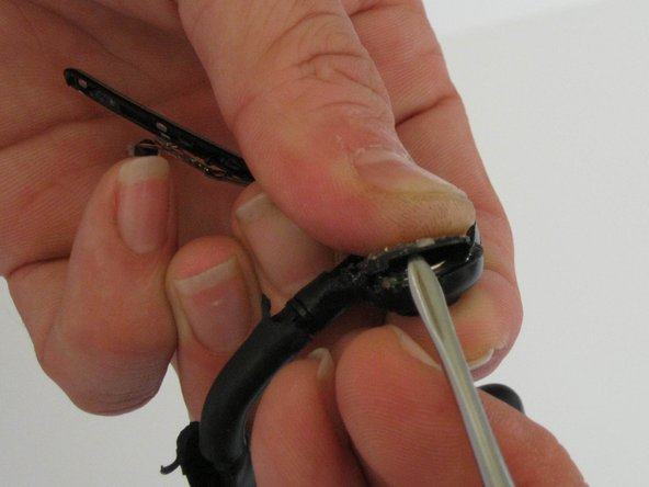

  3. Plantronics Voyager Legend Earpiece Replacement: crwdns2935265:03crwdnd2935265:01crwdnd2935265:02crwdne2935265:0 Plantronics Voyager Legend Earpiece Replacement: crwdns2935265:03crwdnd2935265:02crwdnd2935265:02crwdne2935265:0
    • The two snaps that combine with the adhesive to hold the assembly together are located in the neck of the earpiece unit.

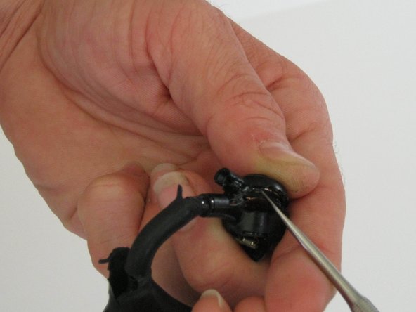

  4. Plantronics Voyager Legend Earpiece Replacement: crwdns2935265:04crwdnd2935265:01crwdnd2935265:02crwdne2935265:0 Plantronics Voyager Legend Earpiece Replacement: crwdns2935265:04crwdnd2935265:02crwdnd2935265:02crwdne2935265:0
    • Remove the top half of the earpiece assembly.
    • Use the pointed end of a small, metal Spudger to loosen the two tabs that hold the earpiece assembly together.
    • While glue is soft and snaps are loosened, remove the entire top half of the earpiece housing.

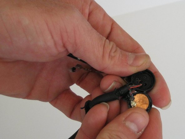

  5. Plantronics Voyager Legend Earpiece Replacement: crwdns2935265:05crwdnd2935265:01crwdnd2935265:03crwdne2935265:0 Plantronics Voyager Legend Earpiece Replacement: crwdns2935265:05crwdnd2935265:02crwdnd2935265:03crwdne2935265:0 Plantronics Voyager Legend Earpiece Replacement: crwdns2935265:05crwdnd2935265:03crwdnd2935265:03crwdne2935265:0
    • Remove the speaker housing.
    • With the copper backing plate displayed, use the pointed end of a small, metal Spudger to disassemble the speaker housing.
    • Using the pointed end of the small, metal Spudger, lift the copper, backing plate away from the speaker unit.

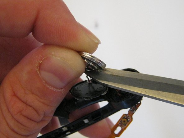

  6. Plantronics Voyager Legend Earpiece Replacement: crwdns2935265:06crwdnd2935265:01crwdnd2935265:02crwdne2935265:0 Plantronics Voyager Legend Earpiece Replacement: crwdns2935265:06crwdnd2935265:02crwdnd2935265:02crwdne2935265:0
    • Use Precision Tweezers to remove the protective screen from the front of the speaker unit.

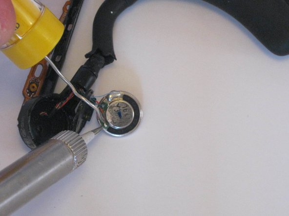

  7. Plantronics Voyager Legend Earpiece Replacement: crwdns2935265:07crwdnd2935265:01crwdnd2935265:03crwdne2935265:0 Plantronics Voyager Legend Earpiece Replacement: crwdns2935265:07crwdnd2935265:02crwdnd2935265:03crwdne2935265:0 Plantronics Voyager Legend Earpiece Replacement: crwdns2935265:07crwdnd2935265:03crwdnd2935265:03crwdne2935265:0
    • Remove the speaker unit and solder a new unit in place.
    • When disconnecting leads, always disconnect as near as possible to the component being replaced, to allow room for reattachment.
    • Locate the leads that connect to the back of the speaker unit.
    • Disconnect the leads from the back of the speaker unit.
    • Remove the speaker unit, and replace by soldering the leads back into their correct locations.
    • Refer to the iFixit soldering guide for assistance with soldering.
