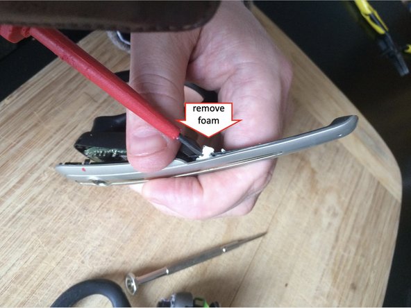

  4. Plantronics Headphone Battery Replacement: crwdns2935265:04crwdnd2935265:01crwdnd2935265:02crwdne2935265:0 Plantronics Headphone Battery Replacement: crwdns2935265:04crwdnd2935265:02crwdnd2935265:02crwdne2935265:0
    • Very carefully open 4 with a sharp screwdriver.
    • The case is glued and sealed with foam at 4.
    • Remove the foam from the case.
