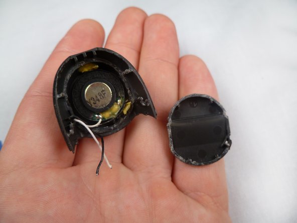

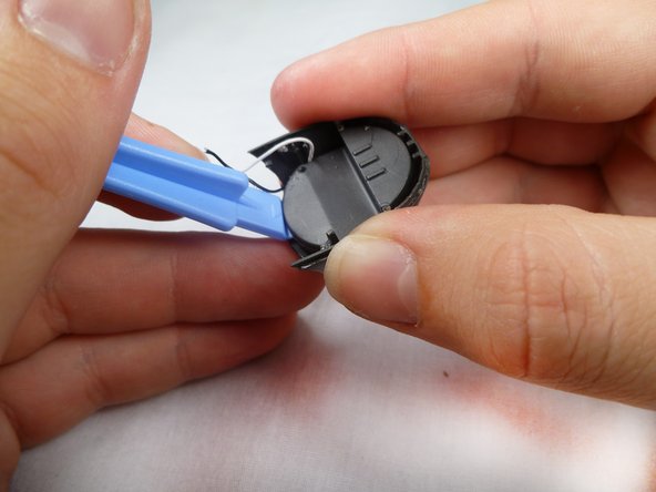

  12. Plantronics CS50 Headset Speaker Replacement, Speaker: crwdns2935265:012crwdnd2935265:01crwdnd2935265:03crwdne2935265:0 Plantronics CS50 Headset Speaker Replacement, Speaker: crwdns2935265:012crwdnd2935265:02crwdnd2935265:03crwdne2935265:0 Plantronics CS50 Headset Speaker Replacement, Speaker: crwdns2935265:012crwdnd2935265:03crwdnd2935265:03crwdne2935265:0
    • Use the heat gun to melt the adhesive that holds the bottom of the casing.
    • Use the plastic opening tool to remove the bottom of the casing.
  13. Plantronics CS50 Headset Speaker Replacement: crwdns2935265:013crwdnd2935265:01crwdnd2935265:03crwdne2935265:0 Plantronics CS50 Headset Speaker Replacement: crwdns2935265:013crwdnd2935265:02crwdnd2935265:03crwdne2935265:0 Plantronics CS50 Headset Speaker Replacement: crwdns2935265:013crwdnd2935265:03crwdnd2935265:03crwdne2935265:0
    • Use the blow dryer or heat gun to melt the glue that holds the speaker.
    • Use the plastic opening tool to carefully remove the speaker from its casing.
