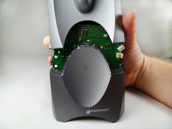

    • Flip over the base unit to reveal the bottom.
  2. Plantronics CS50 Headset Motherboard of the Base Unit Replacement: crwdns2935265:02crwdnd2935265:01crwdnd2935265:02crwdne2935265:0 Plantronics CS50 Headset Motherboard of the Base Unit Replacement: crwdns2935265:02crwdnd2935265:02crwdnd2935265:02crwdne2935265:0
    • Using a #0 screwdriver, remove the two 2.50mm screws.

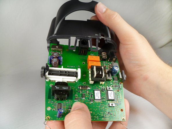

  3. Plantronics CS50 Headset Motherboard of the Base Unit Replacement: crwdns2935265:03crwdnd2935265:01crwdnd2935265:03crwdne2935265:0 Plantronics CS50 Headset Motherboard of the Base Unit Replacement: crwdns2935265:03crwdnd2935265:02crwdnd2935265:03crwdne2935265:0 Plantronics CS50 Headset Motherboard of the Base Unit Replacement: crwdns2935265:03crwdnd2935265:03crwdnd2935265:03crwdne2935265:0
    • Separate, but do not remove, the silver upper piece from the dark lower piece.
    • Carefully disconnect the wires from the motherboard.
    • Remove the silver top of the base.

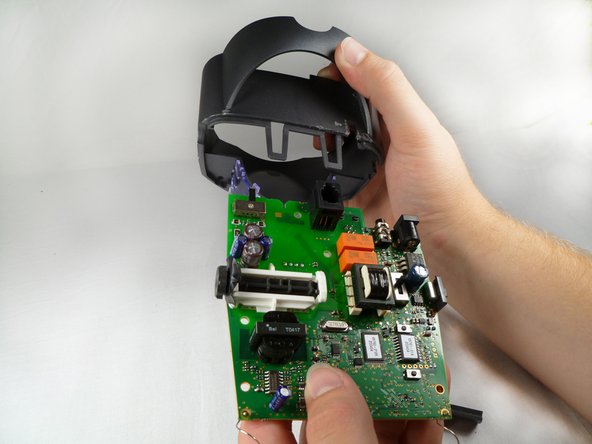

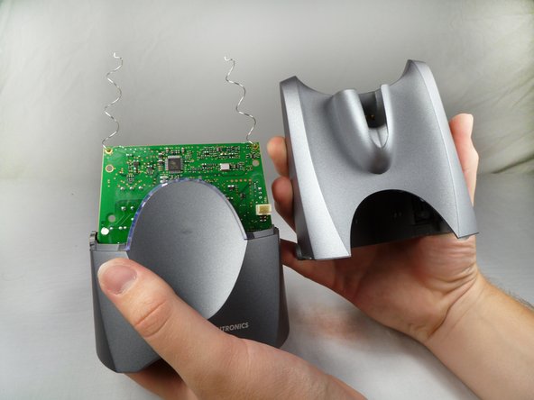

  4. Plantronics CS50 Headset Motherboard of the Base Unit Replacement: crwdns2935265:04crwdnd2935265:01crwdnd2935265:03crwdne2935265:0 Plantronics CS50 Headset Motherboard of the Base Unit Replacement: crwdns2935265:04crwdnd2935265:02crwdnd2935265:03crwdne2935265:0 Plantronics CS50 Headset Motherboard of the Base Unit Replacement: crwdns2935265:04crwdnd2935265:03crwdnd2935265:03crwdne2935265:0
    • Remove the motherboard from the base
