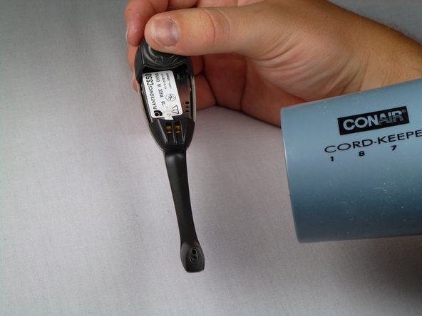

  3. Plantronics CS50 Headset Motherboard Replacement, Microphone: crwdns2935265:03crwdnd2935265:01crwdnd2935265:02crwdne2935265:0 Plantronics CS50 Headset Motherboard Replacement, Microphone: crwdns2935265:03crwdnd2935265:02crwdnd2935265:02crwdne2935265:0
    • Use a hairdryer or heat gun to melt the adhesive along the crevice that joins the black and silver components.
    • Apply additional heat at the tip of the microphone.
  4. Plantronics CS50 Headset Motherboard Replacement: crwdns2935265:04crwdnd2935265:01crwdnd2935265:02crwdne2935265:0 Plantronics CS50 Headset Motherboard Replacement: crwdns2935265:04crwdnd2935265:02crwdnd2935265:02crwdne2935265:0
    • After heating the headset, use the plastic opening tool to carefully pry the black cover from the headset.
    • Be aware of the two plastic connectors inside the headset. If the black cover does not come off smoothly, apply additional heat on the connectors.

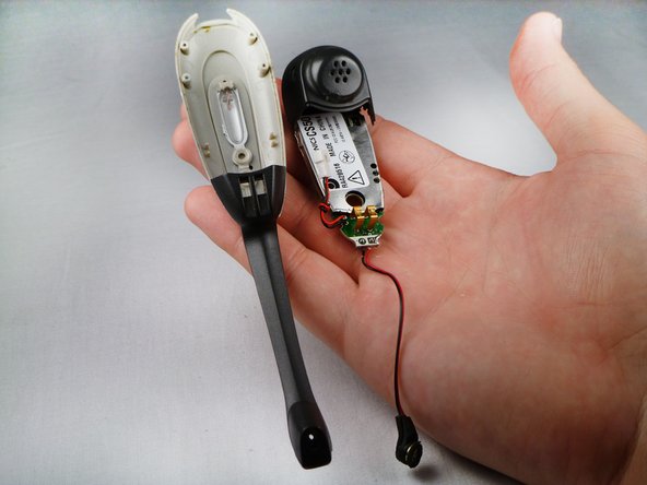

    • Slowly separate the motherboard from the rest of the headset.
  8. Plantronics CS50 Headset Motherboard Replacement: crwdns2935265:08crwdnd2935265:01crwdnd2935265:01crwdne2935265:0
    • Locate the microphone wires on the bottom of the motherboard.
    • Use a hairdryer or heat gun to melt the glue off of the motherboard.
  9. Plantronics CS50 Headset Motherboard Replacement: crwdns2935265:09crwdnd2935265:01crwdnd2935265:01crwdne2935265:0
    • Flip the device over.
    • Use a soldering iron to remove the solder that holds the wires to the motherboard.
    • For help soldering, click here.
    • The microphone piece should be completely detached from the motherboard.
