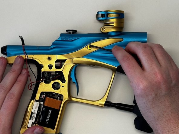

    • Remove the four grip screws with a 5/64" Allen wrench. There are two screws on each side of the marker.
  2. Planet Eclipse LV1 Paintball Marker Eye Replacement: crwdns2935265:02crwdnd2935265:01crwdnd2935265:01crwdne2935265:0

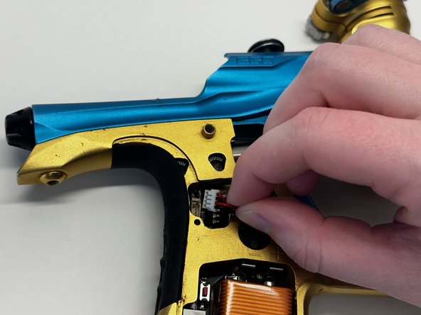

  5. Planet Eclipse LV1 Paintball Marker Eye Replacement: crwdns2935265:05crwdnd2935265:01crwdnd2935265:02crwdne2935265:0 Planet Eclipse LV1 Paintball Marker Eye Replacement: crwdns2935265:05crwdnd2935265:02crwdnd2935265:02crwdne2935265:0
    • Pull the red and black eye sensor wires to disconnect the plug from the control board.
