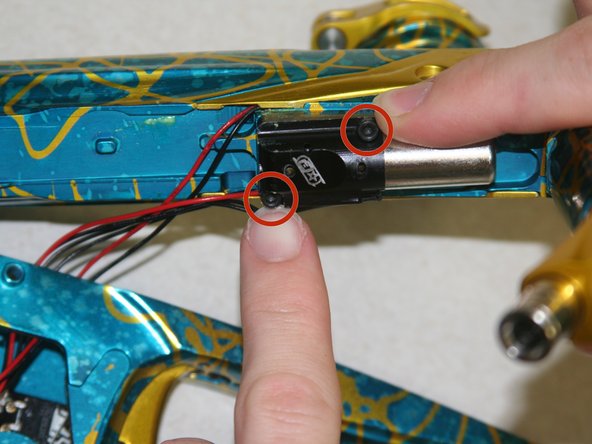

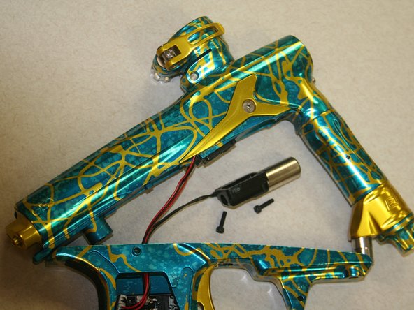

  8. Planet Eclipse Geo3 Solenoid Manifold Gasket Replacement, Solenoid: crwdns2935265:08crwdnd2935265:01crwdnd2935265:03crwdne2935265:0 Planet Eclipse Geo3 Solenoid Manifold Gasket Replacement, Solenoid: crwdns2935265:08crwdnd2935265:02crwdnd2935265:03crwdne2935265:0 Planet Eclipse Geo3 Solenoid Manifold Gasket Replacement, Solenoid: crwdns2935265:08crwdnd2935265:03crwdnd2935265:03crwdne2935265:0
    • Using the Phillips #0 screwdriver, remove the 2 screws in the solenoid.
    • Remove the solenoid.

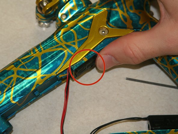

  9. Planet Eclipse Geo3 Solenoid Manifold Gasket Replacement: crwdns2935265:09crwdnd2935265:01crwdnd2935265:01crwdne2935265:0
    • Pry the board connection with the 2 black wires from the terminal.
    • BE CAREFUL: Do not pull hard by the wires or you may dislodge them from the connection instead of removing the connection from the board.
    • Pull out the wires through the opening in the top of the grip and replace the solenoid.

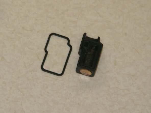

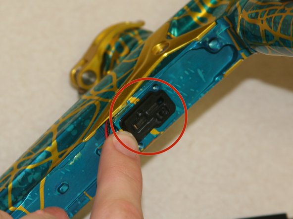

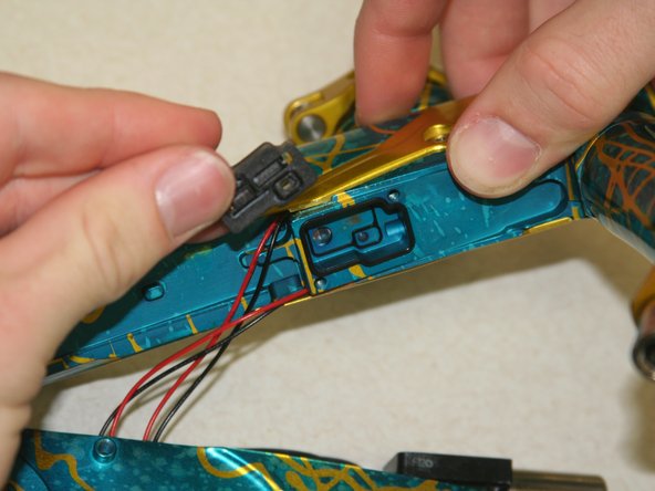

  10. Planet Eclipse Geo3 Solenoid Manifold Gasket Replacement, Solenoid Gasket: crwdns2935265:010crwdnd2935265:01crwdnd2935265:03crwdne2935265:0 Planet Eclipse Geo3 Solenoid Manifold Gasket Replacement, Solenoid Gasket: crwdns2935265:010crwdnd2935265:02crwdnd2935265:03crwdne2935265:0 Planet Eclipse Geo3 Solenoid Manifold Gasket Replacement, Solenoid Gasket: crwdns2935265:010crwdnd2935265:03crwdnd2935265:03crwdne2935265:0
    • Locate the solenoid gasket manifold, underneath the top half of the body.
  11. Planet Eclipse Geo3 Solenoid Manifold Gasket Replacement: crwdns2935265:011crwdnd2935265:01crwdnd2935265:03crwdne2935265:0 Planet Eclipse Geo3 Solenoid Manifold Gasket Replacement: crwdns2935265:011crwdnd2935265:02crwdnd2935265:03crwdne2935265:0 Planet Eclipse Geo3 Solenoid Manifold Gasket Replacement: crwdns2935265:011crwdnd2935265:03crwdnd2935265:03crwdne2935265:0
    • Remove the solenoid gasket manifold by applying pressure with one finger to the part closest to the end of the barrel.
