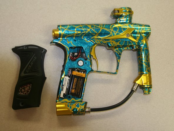

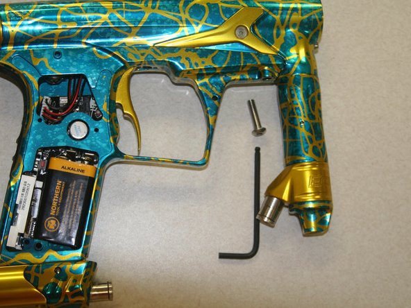

    • Remove the four screws from the grip with the 5/64" allen wrench. There are two on each side.
  2. Planet Eclipse Geo3 Eyes Replacement: crwdns2935265:02crwdnd2935265:01crwdnd2935265:02crwdne2935265:0 Planet Eclipse Geo3 Eyes Replacement: crwdns2935265:02crwdnd2935265:02crwdnd2935265:02crwdne2935265:0
    • Pull the grip away from the frame.
  3. Planet Eclipse Geo3 Eyes Replacement: crwdns2935265:03crwdnd2935265:01crwdnd2935265:02crwdne2935265:0 Planet Eclipse Geo3 Eyes Replacement: crwdns2935265:03crwdnd2935265:02crwdnd2935265:02crwdne2935265:0
    • Pull the grip through the opening.
    • The grip is connected in the middle and is one piece.

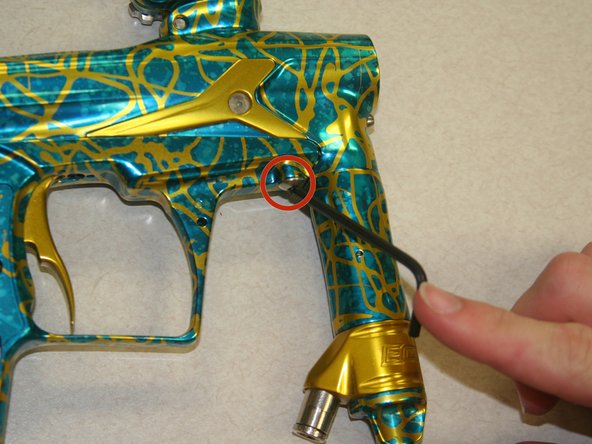

  6. Planet Eclipse Geo3 Eyes Replacement, Body: crwdns2935265:06crwdnd2935265:01crwdnd2935265:03crwdne2935265:0 Planet Eclipse Geo3 Eyes Replacement, Body: crwdns2935265:06crwdnd2935265:02crwdnd2935265:03crwdne2935265:0 Planet Eclipse Geo3 Eyes Replacement, Body: crwdns2935265:06crwdnd2935265:03crwdnd2935265:03crwdne2935265:0
    • Use 1/8" allen wrench to remove screw behind regulator.

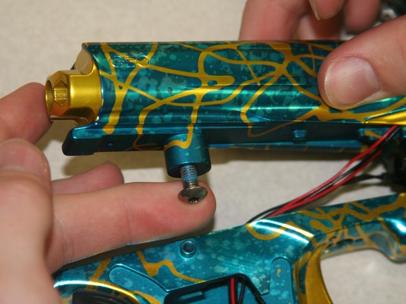

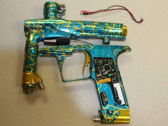

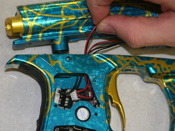

  7. Planet Eclipse Geo3 Eyes Replacement: crwdns2935265:07crwdnd2935265:01crwdnd2935265:03crwdne2935265:0 Planet Eclipse Geo3 Eyes Replacement: crwdns2935265:07crwdnd2935265:02crwdnd2935265:03crwdne2935265:0 Planet Eclipse Geo3 Eyes Replacement: crwdns2935265:07crwdnd2935265:03crwdnd2935265:03crwdne2935265:0
    • Use 1/8" allen wrench to loosen the screw inside the grip on the right side.
    • The screw only needs to be turned a couple of times.
    • Slide the upper frame forward on the rails and remove the screw from the slot to separate the two halves of the body.
    • BE CAREFUL: Do not pull the two frames apart too much or too quickly. This may cause the wires to be damaged.

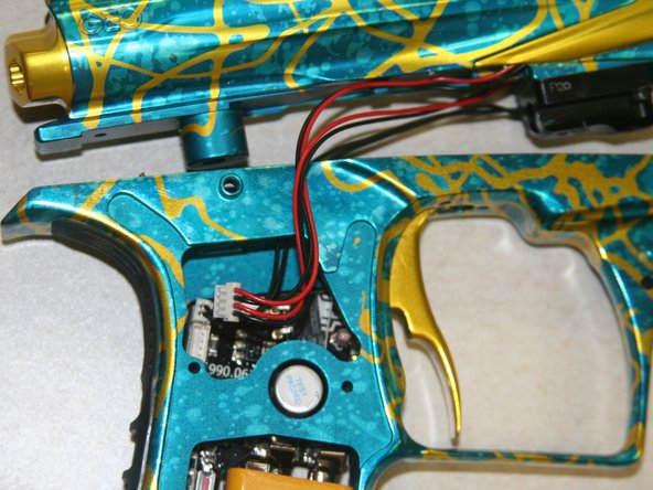

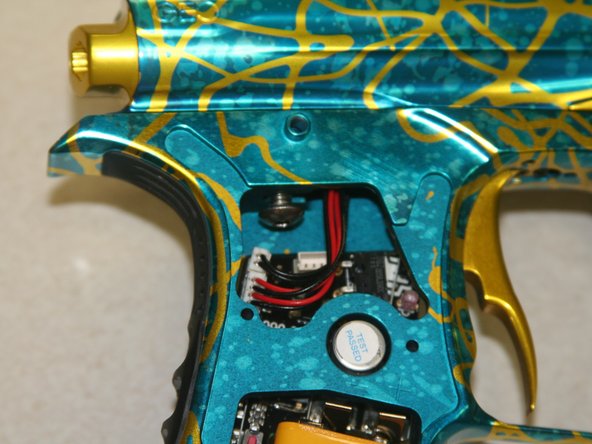

  8. Planet Eclipse Geo3 Eyes Replacement, Eyes: crwdns2935265:08crwdnd2935265:01crwdnd2935265:03crwdne2935265:0 Planet Eclipse Geo3 Eyes Replacement, Eyes: crwdns2935265:08crwdnd2935265:02crwdnd2935265:03crwdne2935265:0 Planet Eclipse Geo3 Eyes Replacement, Eyes: crwdns2935265:08crwdnd2935265:03crwdnd2935265:03crwdne2935265:0
    • Use a prying tool or tweezers to gently remove the connection from the board. It is the connection with 2 black and 2 red wires.
    • Pull the wire through the opening.

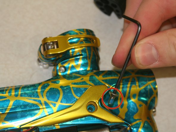

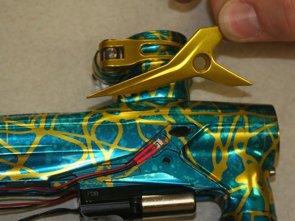

  9. Planet Eclipse Geo3 Eyes Replacement: crwdns2935265:09crwdnd2935265:01crwdnd2935265:03crwdne2935265:0 Planet Eclipse Geo3 Eyes Replacement: crwdns2935265:09crwdnd2935265:02crwdnd2935265:03crwdne2935265:0 Planet Eclipse Geo3 Eyes Replacement: crwdns2935265:09crwdnd2935265:03crwdnd2935265:03crwdne2935265:0

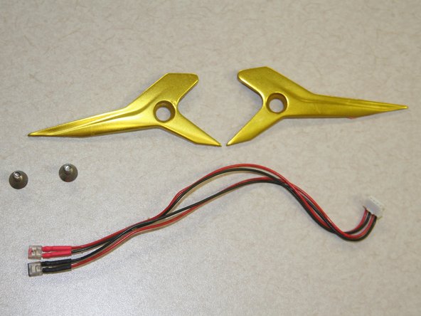

    • Use 5/64" allen key to remove each screw from eye covers (Located on both sides of the paintball marker.)
    • Pull off eye covers. (Located on both sides of the paintball marker.)
  10. Planet Eclipse Geo3 Eyes Replacement: crwdns2935265:010crwdnd2935265:01crwdnd2935265:03crwdne2935265:0 Planet Eclipse Geo3 Eyes Replacement: crwdns2935265:010crwdnd2935265:02crwdnd2935265:03crwdne2935265:0 Planet Eclipse Geo3 Eyes Replacement: crwdns2935265:010crwdnd2935265:03crwdnd2935265:03crwdne2935265:0
    • Gently pull out the two eyes, one on each side of the paintball marker.
    • The red wire leading to the eye on the right side of the paintball marker. The black wire leads to the eye on the left side.
