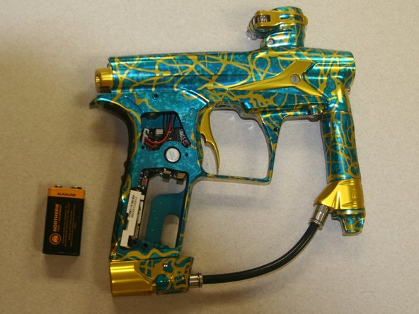

    • Remove the four screws from the grip with the 5/64" allen wrench. There are two on each side.
  2. Planet Eclipse Geo3 Battery Replacement: crwdns2935265:02crwdnd2935265:01crwdnd2935265:02crwdne2935265:0 Planet Eclipse Geo3 Battery Replacement: crwdns2935265:02crwdnd2935265:02crwdnd2935265:02crwdne2935265:0
    • Pull the grip away from the frame.
  3. Planet Eclipse Geo3 Battery Replacement: crwdns2935265:03crwdnd2935265:01crwdnd2935265:02crwdne2935265:0 Planet Eclipse Geo3 Battery Replacement: crwdns2935265:03crwdnd2935265:02crwdnd2935265:02crwdne2935265:0
    • Pull the grip through the opening.
    • The grip is connected in the middle and is one piece.
  4. Planet Eclipse Geo3 Battery Replacement, Battery: crwdns2935265:04crwdnd2935265:01crwdnd2935265:02crwdne2935265:0 Planet Eclipse Geo3 Battery Replacement, Battery: crwdns2935265:04crwdnd2935265:02crwdnd2935265:02crwdne2935265:0
    • Push out top of battery from left side of grip.
  5. Planet Eclipse Geo3 Battery Replacement: crwdns2935265:05crwdnd2935265:01crwdnd2935265:01crwdne2935265:0
    • Push new battery into right side of grip, inserting the bottom first.
    • Be sure to match the signs of the battery and the terminals. The terminals are labeled just above the battery on the right side.
To reassemble your device, follow the Disassembling Planet Eclipse Geo3 Grip in reverse.
