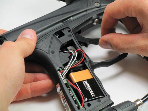

    • Use the 5/64" hex key to remove the screw shown.
    • Remove the grip panel by gently holding the bottom of the panel and lifting the panel off.
    • If you are only replacing the battery, skip the next step.
    • The screws in this guide are interchangeable with those shown in the Eyes replacement guide.

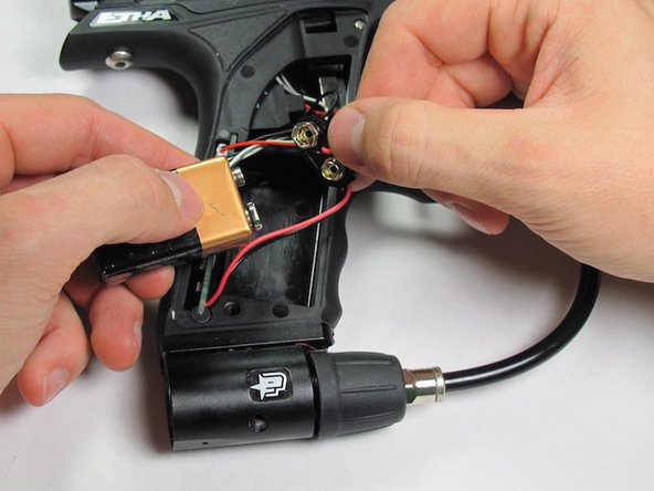

  3. Planet Eclipse Etha Trigger Replacement: crwdns2935265:03crwdnd2935265:01crwdnd2935265:02crwdne2935265:0 Planet Eclipse Etha Trigger Replacement: crwdns2935265:03crwdnd2935265:02crwdnd2935265:02crwdne2935265:0
    • Carefully remove the 9V battery and connector.
    • Remove the 9V battery from the connector.
