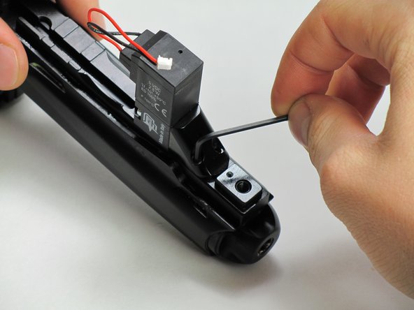

  9. Planet Eclipse Etha Solenoid Replacement, Solenoid: crwdns2935265:09crwdnd2935265:01crwdnd2935265:02crwdne2935265:0 Planet Eclipse Etha Solenoid Replacement, Solenoid: crwdns2935265:09crwdnd2935265:02crwdnd2935265:02crwdne2935265:0
    • Remove the two black hex bolts that connect the solenoid mount to the body.
    • Use the 5/64" Allen Key to rotate each screw counter clockwise.

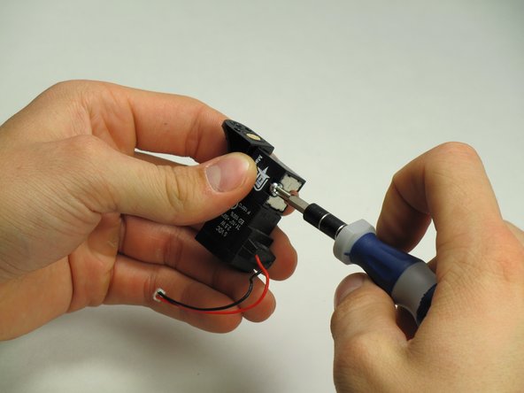

  10. Planet Eclipse Etha Solenoid Replacement: crwdns2935265:010crwdnd2935265:01crwdnd2935265:02crwdne2935265:0 Planet Eclipse Etha Solenoid Replacement: crwdns2935265:010crwdnd2935265:02crwdnd2935265:02crwdne2935265:0
    • Remove the two Phillips head screws that connect the solenoid to its mount.
    • Use a Phillip's head screwdriver and rotate each screw counter clockwise.
    • Do not attempt to dismantle the solenoid. Intentionally dismantling or tampering with the solenoid voids the manufacturer’s warranty.
