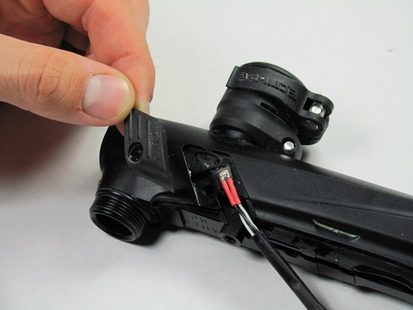

  9. Planet Eclipse Etha Eyes Replacement, Eyes: crwdns2935265:09crwdnd2935265:01crwdnd2935265:02crwdne2935265:0 Planet Eclipse Etha Eyes Replacement, Eyes: crwdns2935265:09crwdnd2935265:02crwdnd2935265:02crwdne2935265:0
    • Use the 5/64" hex key to turn the screw counterclockwise.
    • Carefully remove the screw and place it off to the side.
    • Remove the panel and place it off to the side.

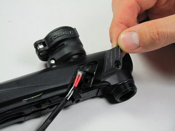

  10. Planet Eclipse Etha Eyes Replacement: crwdns2935265:010crwdnd2935265:01crwdnd2935265:02crwdne2935265:0 Planet Eclipse Etha Eyes Replacement: crwdns2935265:010crwdnd2935265:02crwdnd2935265:02crwdne2935265:0
    • Carefully flip the marker over.
    • Remove the screw and place it off to the side.
    • Carefully remove the panel and place it off to the side.

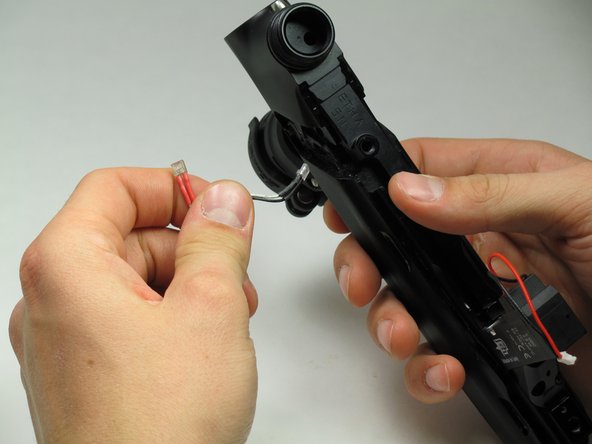

  11. Planet Eclipse Etha Eyes Replacement: crwdns2935265:011crwdnd2935265:01crwdnd2935265:02crwdne2935265:0 Planet Eclipse Etha Eyes Replacement: crwdns2935265:011crwdnd2935265:02crwdnd2935265:02crwdne2935265:0
    • Grip the marker with one hand and gently pull the eyes out with your other hand.
