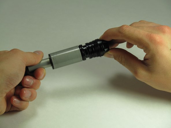

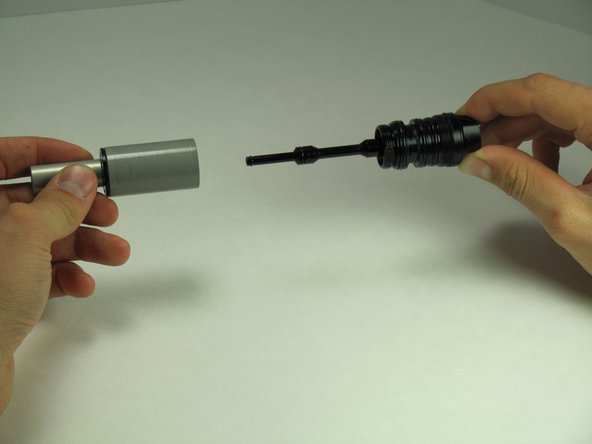

  2. Planet Eclipse Etha Bolt O-rings Replacement: crwdns2935265:02crwdnd2935265:01crwdnd2935265:02crwdne2935265:0 Planet Eclipse Etha Bolt O-rings Replacement: crwdns2935265:02crwdnd2935265:02crwdnd2935265:02crwdne2935265:0
    • Slide the bolt tip and spring off of the main assembly.
    • Keep a towel handy, you may get some grease on your hands.

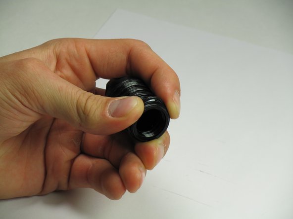

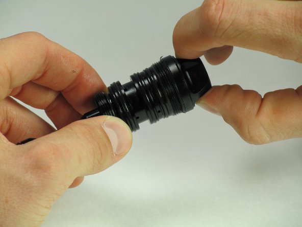

  3. Planet Eclipse Etha Bolt O-rings Replacement: crwdns2935265:03crwdnd2935265:01crwdnd2935265:03crwdne2935265:0 Planet Eclipse Etha Bolt O-rings Replacement: crwdns2935265:03crwdnd2935265:02crwdnd2935265:03crwdne2935265:0 Planet Eclipse Etha Bolt O-rings Replacement: crwdns2935265:03crwdnd2935265:03crwdnd2935265:03crwdne2935265:0
    • Unscrew the casing from the rest of the bolt.
    • Again, you may get some grease on your hands during this step.

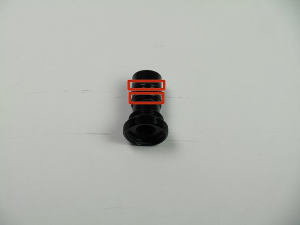

  4. Planet Eclipse Etha Bolt O-rings Replacement: crwdns2935265:04crwdnd2935265:01crwdnd2935265:03crwdne2935265:0 Planet Eclipse Etha Bolt O-rings Replacement: crwdns2935265:04crwdnd2935265:02crwdnd2935265:03crwdne2935265:0 Planet Eclipse Etha Bolt O-rings Replacement: crwdns2935265:04crwdnd2935265:03crwdnd2935265:03crwdne2935265:0
    • Grab the flat surface shown.
    • Unscrew this portion counter clockwise to remove it.
    • If you're having trouble unscrewing the part, try using a small wrench.

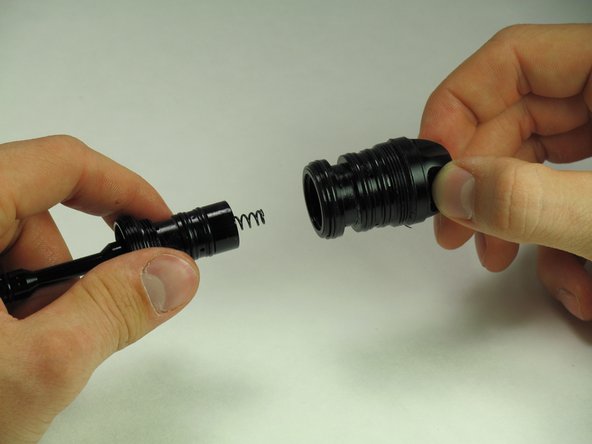

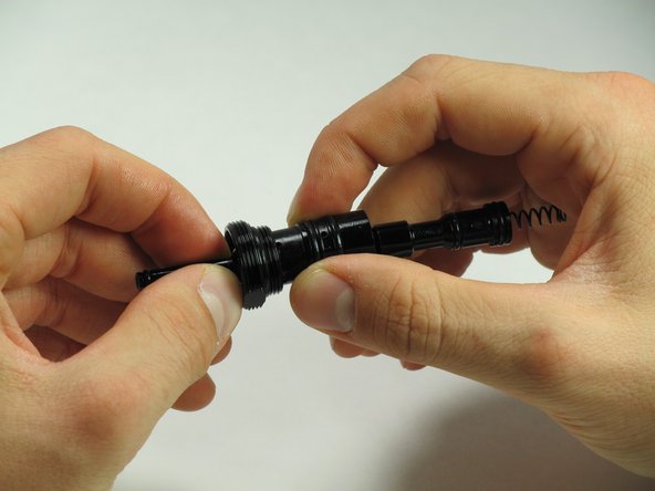

  5. Planet Eclipse Etha Bolt O-rings Replacement: crwdns2935265:05crwdnd2935265:01crwdnd2935265:02crwdne2935265:0 Planet Eclipse Etha Bolt O-rings Replacement: crwdns2935265:05crwdnd2935265:02crwdnd2935265:02crwdne2935265:0
    • Grab the threaded cover and slide it away from the spring.
    • The bolt should now be in three pieces.
    • The threaded cover is the same part that you unscrewed in the last step.

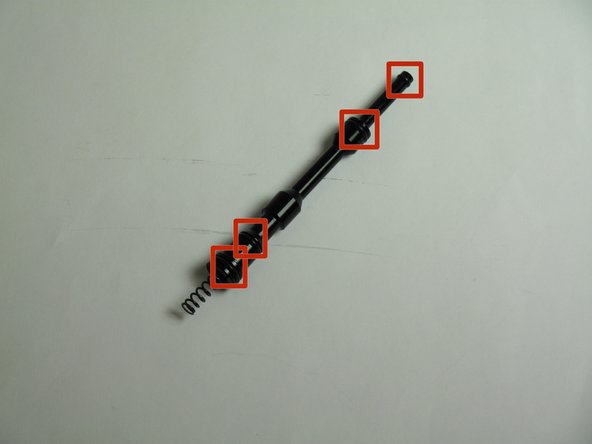

  6. Planet Eclipse Etha Bolt O-rings Replacement: crwdns2935265:06crwdnd2935265:01crwdnd2935265:03crwdne2935265:0 Planet Eclipse Etha Bolt O-rings Replacement: crwdns2935265:06crwdnd2935265:02crwdnd2935265:03crwdne2935265:0 Planet Eclipse Etha Bolt O-rings Replacement: crwdns2935265:06crwdnd2935265:03crwdnd2935265:03crwdne2935265:0
    • Replace and lubricate the 9 marked O-rings.
    • O-ring removal will be explained in the next step.

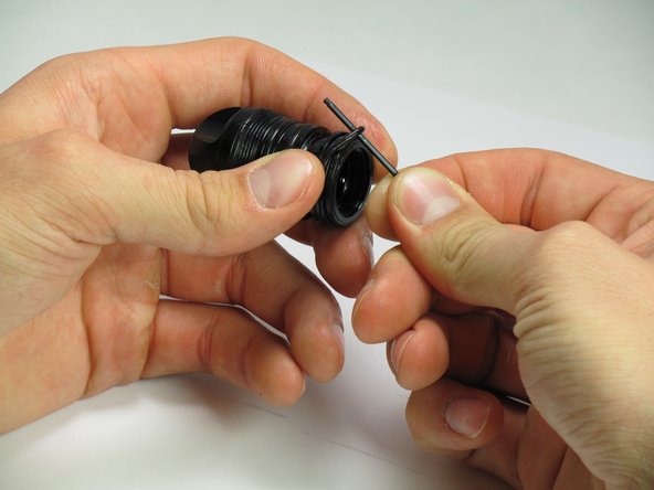

  7. Planet Eclipse Etha Bolt O-rings Replacement: crwdns2935265:07crwdnd2935265:01crwdnd2935265:03crwdne2935265:0 Planet Eclipse Etha Bolt O-rings Replacement: crwdns2935265:07crwdnd2935265:02crwdnd2935265:03crwdne2935265:0 Planet Eclipse Etha Bolt O-rings Replacement: crwdns2935265:07crwdnd2935265:03crwdnd2935265:03crwdne2935265:0
    • Grab the O-ring on the sides.
    • Pinch the O-ring upwards to create a gap between the metal and the ring.
    • Use a small object to slip into the loop and pull the O-ring off gently.
    • We recommend using a small Allen Key for this.
