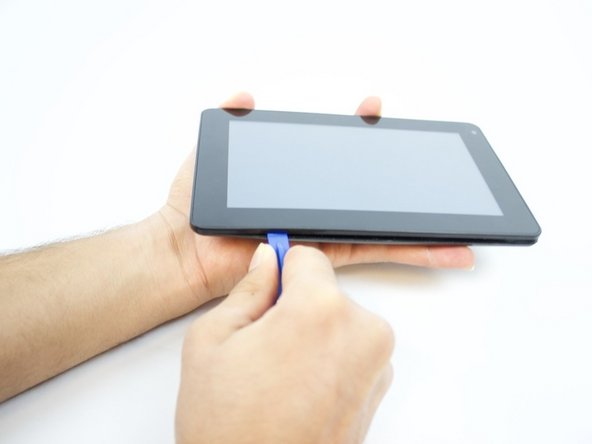

    • Insert an iFixit opening tool between the body and display of the tablet at the bottom of the device where the charging port is.
    • Slide the tool along the gap you are creating, moving to the right direction against the mini USB port.

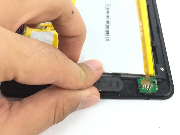

  13. Pipo Smart S1 Speaker Replacement: crwdns2935265:013crwdnd2935265:01crwdnd2935265:01crwdne2935265:0
    • Using your fingers, pry off the back cover of the device once you have created a gap between the covers.

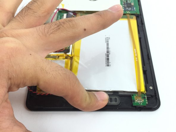

  14. Pipo Smart S1 Speaker Replacement: crwdns2935265:014crwdnd2935265:01crwdnd2935265:01crwdne2935265:0

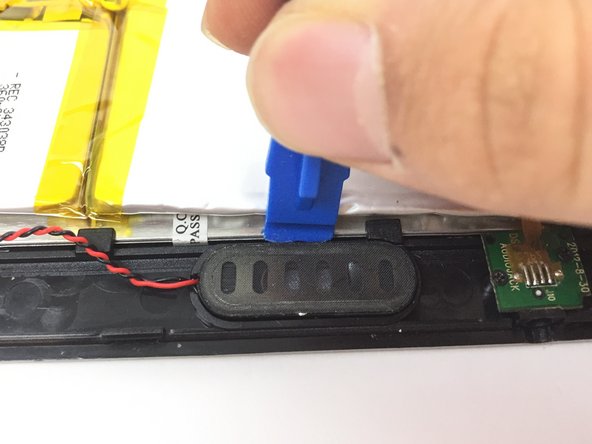

    • Find the speaker at the bottom of the tablet.
    • The speaker looks like a black oval with a red and black wire connected to it.
  15. Pipo Smart S1 Speaker Replacement: crwdns2935265:015crwdnd2935265:01crwdnd2935265:02crwdne2935265:0 Pipo Smart S1 Speaker Replacement: crwdns2935265:015crwdnd2935265:02crwdnd2935265:02crwdne2935265:0
    • Pry out the speaker using the spudger.
    • Alternate sides to help avoid damage to the speaker's molding.

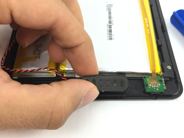

  16. Pipo Smart S1 Speaker Replacement: crwdns2935265:016crwdnd2935265:01crwdnd2935265:02crwdne2935265:0 Pipo Smart S1 Speaker Replacement: crwdns2935265:016crwdnd2935265:02crwdnd2935265:02crwdne2935265:0
    • Use your fingers to pull the speaker out of the device.
