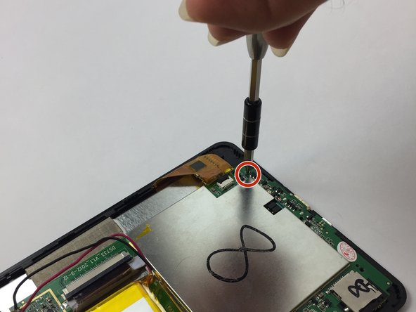

  11. Pipo Smart S1 Screen Replacement, Screen: crwdns2935265:011crwdnd2935265:01crwdnd2935265:02crwdne2935265:0 Pipo Smart S1 Screen Replacement, Screen: crwdns2935265:011crwdnd2935265:02crwdnd2935265:02crwdne2935265:0
    • On the bottom of your tablet, take your J000 screwdriver and take out the three 3mm screws that hold down the motherboard.

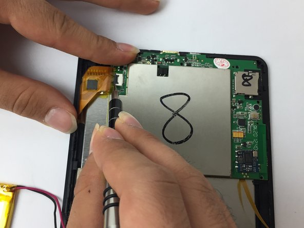

  12. Pipo Smart S1 Screen Replacement: crwdns2935265:012crwdnd2935265:01crwdnd2935265:02crwdne2935265:0 Pipo Smart S1 Screen Replacement: crwdns2935265:012crwdnd2935265:02crwdnd2935265:02crwdne2935265:0
    • Locate the orange connection strip that connects the motherboard to the display screen. Use your J001 to pry the connector off.

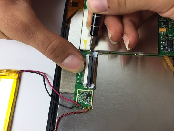

  13. Pipo Smart S1 Screen Replacement: crwdns2935265:013crwdnd2935265:01crwdnd2935265:02crwdne2935265:0 Pipo Smart S1 Screen Replacement: crwdns2935265:013crwdnd2935265:02crwdnd2935265:02crwdne2935265:0
    • Take your J001 screwdriver and carefully push out the cable ribbon alternating on both sides.
  14. Pipo Smart S1 Screen Replacement: crwdns2935265:014crwdnd2935265:01crwdnd2935265:01crwdne2935265:0
    • After you loosened the cable ribbon with your J001 screwdriver, pull it out with your fingers.

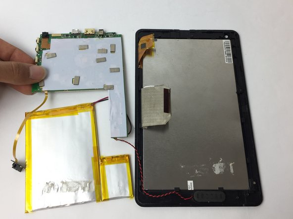

  15. Pipo Smart S1 Screen Replacement: crwdns2935265:015crwdnd2935265:01crwdnd2935265:02crwdne2935265:0 Pipo Smart S1 Screen Replacement: crwdns2935265:015crwdnd2935265:02crwdnd2935265:02crwdne2935265:0
    • After the motherboard is freed from screws and connections, now you can lift it with two fingers and slowly place it next to your device front cover that holds the display screen.
    • The speaker connection that is on the front cover of your device is still attached to the motherboard; therefore place the motherboard close to the front cover.

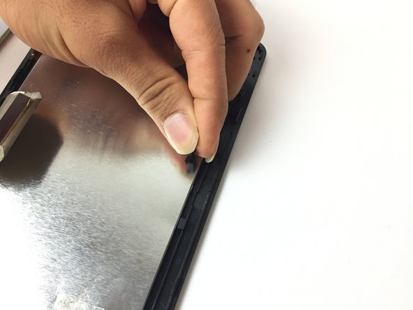

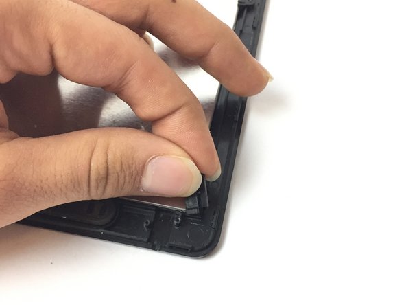

  17. Pipo Smart S1 Screen Replacement: crwdns2935265:017crwdnd2935265:01crwdnd2935265:01crwdne2935265:0
    • Pry off the display screen using J001 screwdriver.
  18. Pipo Smart S1 Screen Replacement: crwdns2935265:018crwdnd2935265:01crwdnd2935265:01crwdne2935265:0
    • Using your fingers, remove the defective screen from your device.
