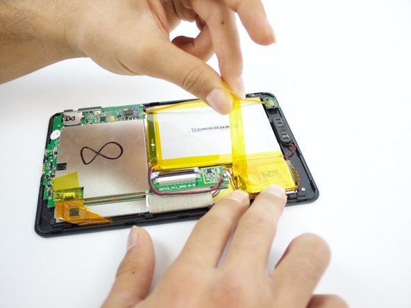

    • Lift the white tape with your fingers, then lift the yellow tape that holds the battery extension.

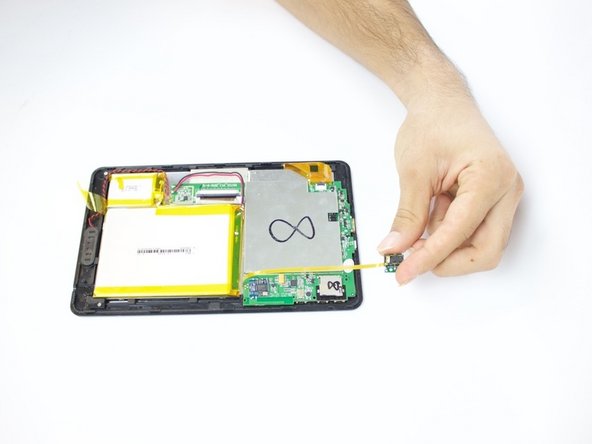

    • Lift the headphone jack and move it to the other side, placing it on the surface you are working on.

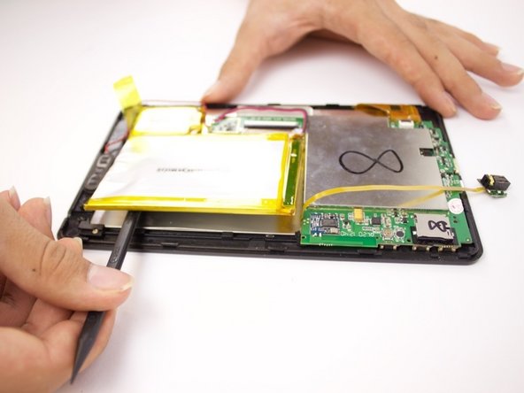

    • Use a spudger to pry the battery and detach it from the glue underneath it.
    • Be careful not to pinch the battery—lithium batteries are hazardous and prone to short circuiting, and thus burning and/or exploding.

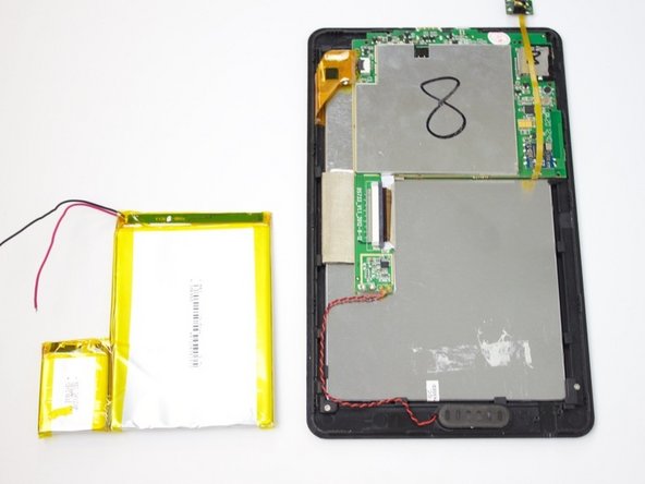

  10. Pipo Smart S1 Battery Replacement: crwdns2935265:010crwdnd2935265:01crwdnd2935265:02crwdne2935265:0 Pipo Smart S1 Battery Replacement: crwdns2935265:010crwdnd2935265:02crwdnd2935265:02crwdne2935265:0
    • Remove the two wires. Then remove the battery completely from the device.
    • Make sure you tape the negative and positive battery wires to keep them from short-circuiting.
