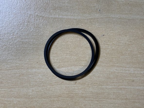

  8. Pioneer UDP-LX500 UHD Blu-ray Player Disc Tray Belt Replacement, Fit the replacement belt: crwdns2935265:08crwdnd2935265:01crwdnd2935265:02crwdne2935265:0 Pioneer UDP-LX500 UHD Blu-ray Player Disc Tray Belt Replacement, Fit the replacement belt: crwdns2935265:08crwdnd2935265:02crwdnd2935265:02crwdne2935265:0
    • Before fitting the new belt, check it is clean and dry.
    • Fit the replacement belt across the white wheel and the black motor spindle.
    • Confirm the belt moves nicely by gently sliding the tray manually in and out a few times.
    • An old and new belt are shown on top of each other here, showing the old belt has stretched slightly, causing the slippage.
    • Reverse the dismantling instructions to reassemble the player.
    • The new belt can be tested once the disc stabilising panel is fitted. It is also strongly recommended to fit the transport cover, or lay it loosely across the top of the transport, to cover the laser.
