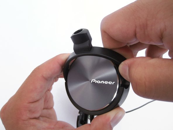

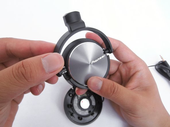

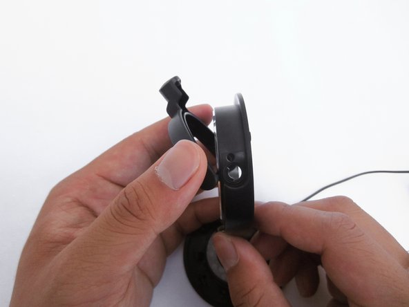

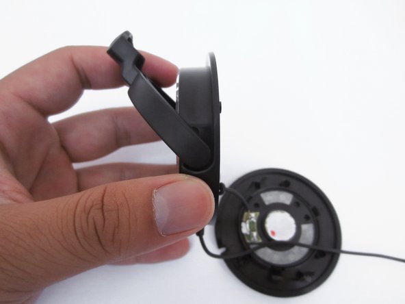

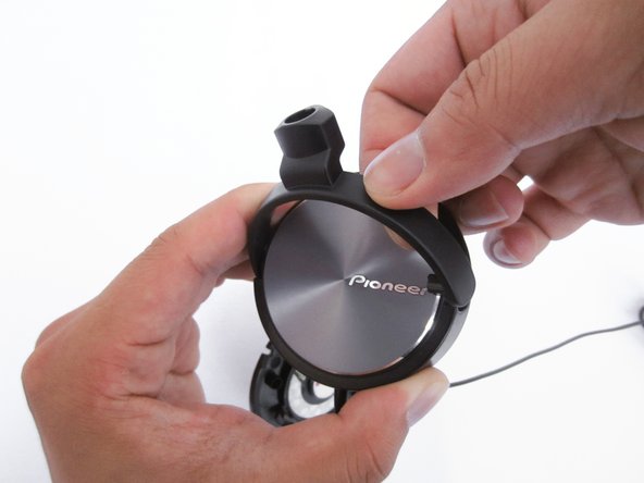

    • Separate the swivel from the ear cup.
  8. Pioneer Steel Wheels Swivels Replacement: crwdns2935265:08crwdnd2935265:01crwdnd2935265:03crwdne2935265:0 Pioneer Steel Wheels Swivels Replacement: crwdns2935265:08crwdnd2935265:02crwdnd2935265:03crwdne2935265:0 Pioneer Steel Wheels Swivels Replacement: crwdns2935265:08crwdnd2935265:03crwdnd2935265:03crwdne2935265:0
    • Grab the end of the swivel that is closest to "Pioneer" and pull outward.
  9. Pioneer Steel Wheels Swivels Replacement: crwdns2935265:09crwdnd2935265:01crwdnd2935265:03crwdne2935265:0 Pioneer Steel Wheels Swivels Replacement: crwdns2935265:09crwdnd2935265:02crwdnd2935265:03crwdne2935265:0 Pioneer Steel Wheels Swivels Replacement: crwdns2935265:09crwdnd2935265:03crwdnd2935265:03crwdne2935265:0
    • Switch sides and grab the other end of the swivel and pull outward as well.
    • During reassembly, insert the swivel back at the tilted position so it can be popped in with ease.
