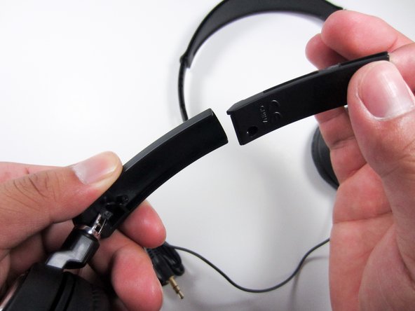

    • With the headband fully extended, hold the base of the headband with one hand and with your other hand, hold the top of the headband.
    • With force, pull upwards.
  3. Pioneer Steel Wheels Folding Hinges Replacement: crwdns2935265:03crwdnd2935265:01crwdnd2935265:03crwdne2935265:0 Pioneer Steel Wheels Folding Hinges Replacement: crwdns2935265:03crwdnd2935265:02crwdnd2935265:03crwdne2935265:0 Pioneer Steel Wheels Folding Hinges Replacement: crwdns2935265:03crwdnd2935265:03crwdnd2935265:03crwdne2935265:0
    • Remove the rail-piece that is now sticking up by pulling it up and out of the headphone.
    • Repeat on the opposite side and the headband will be released.
    • During reassembly, make the sure the rail-pieces match their respective sides so the headband reinserts properly.

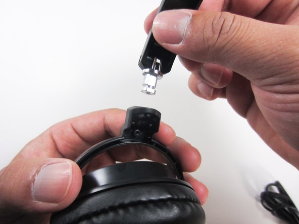

  4. Pioneer Steel Wheels Folding Hinges Replacement, Folding Hinges: crwdns2935265:04crwdnd2935265:01crwdnd2935265:02crwdne2935265:0 Pioneer Steel Wheels Folding Hinges Replacement, Folding Hinges: crwdns2935265:04crwdnd2935265:02crwdnd2935265:02crwdne2935265:0
    • While holding the base of the headband with one hand, hold the ear cup with the other hand.
    • Pull them apart to reveal the screw.
  5. Pioneer Steel Wheels Folding Hinges Replacement: crwdns2935265:05crwdnd2935265:01crwdnd2935265:02crwdne2935265:0 Pioneer Steel Wheels Folding Hinges Replacement: crwdns2935265:05crwdnd2935265:02crwdnd2935265:02crwdne2935265:0
    • While apart, remove the screw from the headphone.
  6. Pioneer Steel Wheels Folding Hinges Replacement: crwdns2935265:06crwdnd2935265:01crwdnd2935265:02crwdne2935265:0 Pioneer Steel Wheels Folding Hinges Replacement: crwdns2935265:06crwdnd2935265:02crwdnd2935265:02crwdne2935265:0

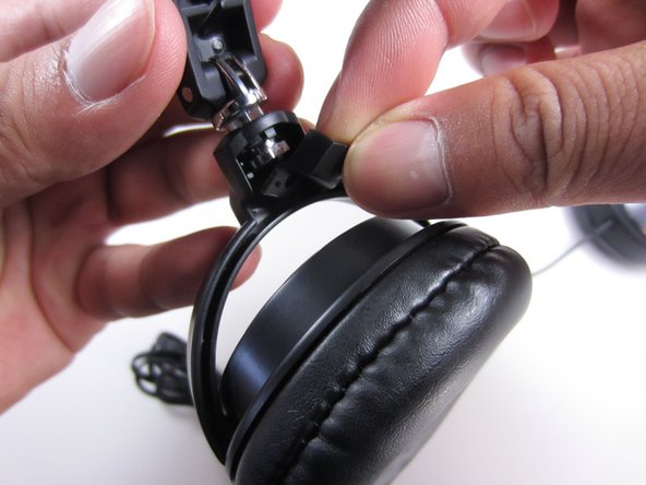

    • Loosen the plastic cover piece that protects the chrome folding hinge.
    • Remove the plastic cover piece.
    • During reassembly, make sure the plastic covering piece hooks onto the base of the chrome hinge before screwing it back in.
  7. Pioneer Steel Wheels Folding Hinges Replacement: crwdns2935265:07crwdnd2935265:01crwdnd2935265:02crwdne2935265:0 Pioneer Steel Wheels Folding Hinges Replacement: crwdns2935265:07crwdnd2935265:02crwdnd2935265:02crwdne2935265:0
    • Holding the ear cup with one hand, pull up on the base of the headband with the other hand to release the folding hinge.
    • Repeat for the opposite side if necessary.
