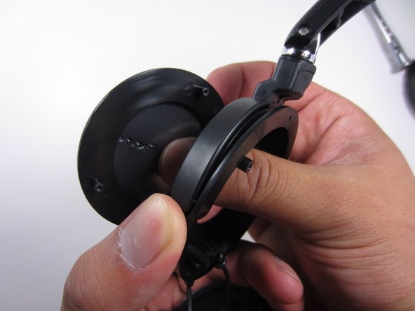

  4. Pioneer Steel Wheels Aluminum Plates Replacement, Foam Ear Pads: crwdns2935265:04crwdnd2935265:01crwdnd2935265:02crwdne2935265:0 Pioneer Steel Wheels Aluminum Plates Replacement, Foam Ear Pads: crwdns2935265:04crwdnd2935265:02crwdnd2935265:02crwdne2935265:0
    • While holding the base of the ear cup with one hand, insert your index finger from your other hand into the inside of the foam ear piece.
  5. Pioneer Steel Wheels Aluminum Plates Replacement: crwdns2935265:05crwdnd2935265:01crwdnd2935265:03crwdne2935265:0 Pioneer Steel Wheels Aluminum Plates Replacement: crwdns2935265:05crwdnd2935265:02crwdnd2935265:03crwdne2935265:0 Pioneer Steel Wheels Aluminum Plates Replacement: crwdns2935265:05crwdnd2935265:03crwdnd2935265:03crwdne2935265:0
    • With slight force, peel the foam ear pieces away from the ear cup.
    • Make sure to pull out the foam ear pieces slowly. Pulling on them fast will tear the leather wrapping.
    • Repeat for the opposite side if necessary.

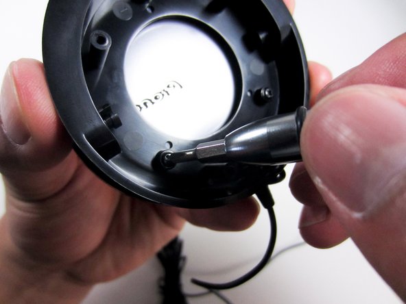

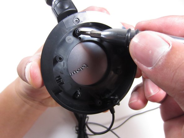

  6. Pioneer Steel Wheels Aluminum Plates Replacement, Drivers: crwdns2935265:06crwdnd2935265:01crwdnd2935265:02crwdne2935265:0 Pioneer Steel Wheels Aluminum Plates Replacement, Drivers: crwdns2935265:06crwdnd2935265:02crwdnd2935265:02crwdne2935265:0
    • Remove the three screws located on the driver cover of the ear cup with the PH0 Phillips screw driver.

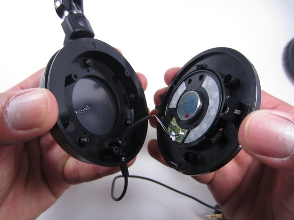

  7. Pioneer Steel Wheels Aluminum Plates Replacement: crwdns2935265:07crwdnd2935265:01crwdnd2935265:02crwdne2935265:0 Pioneer Steel Wheels Aluminum Plates Replacement: crwdns2935265:07crwdnd2935265:02crwdnd2935265:02crwdne2935265:0

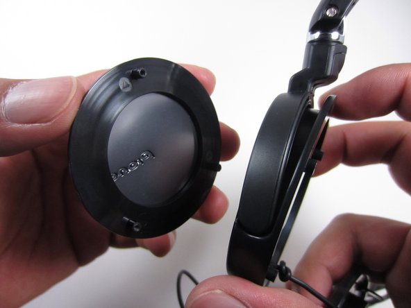

    • Pull the driver cover away from the headphone.
    • Do not pull the driver cover away too fast since there are wires connecting the driver to the ear cup.
    • During reassembly, make sure the two wires are pointing downward before screwing the driver back in.

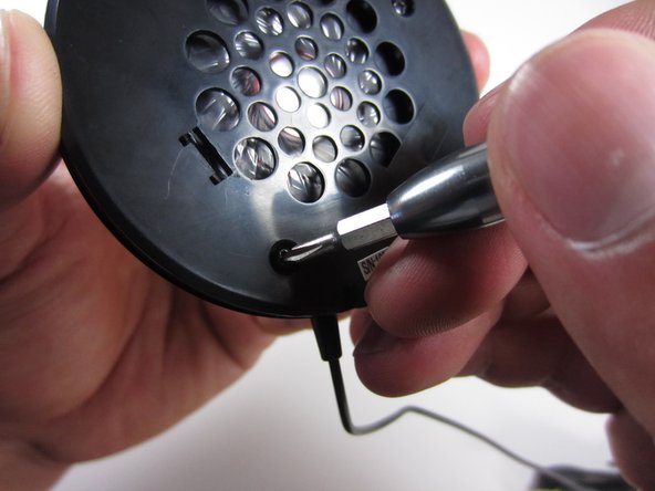

  8. Pioneer Steel Wheels Aluminum Plates Replacement, Aluminum Plates: crwdns2935265:08crwdnd2935265:01crwdnd2935265:03crwdne2935265:0 Pioneer Steel Wheels Aluminum Plates Replacement, Aluminum Plates: crwdns2935265:08crwdnd2935265:02crwdnd2935265:03crwdne2935265:0 Pioneer Steel Wheels Aluminum Plates Replacement, Aluminum Plates: crwdns2935265:08crwdnd2935265:03crwdnd2935265:03crwdne2935265:0
    • Remove the three screws located on the driver casing.
