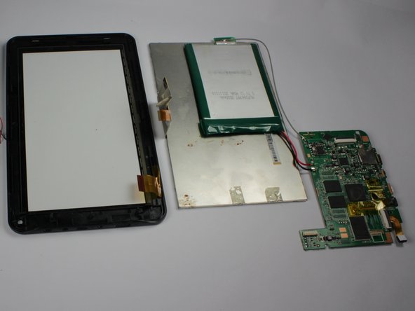

    • Insert your plastic spudger in the opening near the HDMI port.
    • Gently pry the back cover of the R1 from the the front by using the spudger along the edges.
    • Do not pull the back cover straight off the R1 as components of the speakers will be attached to both sides.
  2. Pioneer R1 Touch Screen Replacement: crwdns2935265:02crwdnd2935265:01crwdnd2935265:01crwdne2935265:0
    • Lay the R1 flat like an open book.
    • This will prevent the speakers from becoming disconnected from the motherboard.
  3. Pioneer R1 Touch Screen Replacement: crwdns2935265:03crwdnd2935265:01crwdnd2935265:01crwdne2935265:0
    • Remove the tape that is holding the motherboard to the display and covering the cable attachments.
    • Peel back just the end of this tape to free the front facing camera.
  4. Pioneer R1 Touch Screen Replacement: crwdns2935265:04crwdnd2935265:01crwdnd2935265:01crwdne2935265:0
    • Remove the three 4 mm screws along the base of the motherboard with a Phillips #00 Screwdriver.
  5. Pioneer R1 Touch Screen Replacement: crwdns2935265:05crwdnd2935265:01crwdnd2935265:01crwdne2935265:0
    • Disengage the two cable locks using your spudger or your finger nail.
    • Slide the cable free from the disengaged lock.
    • Do not pull across the cables as this may tear and permanently damage it.
  6. Pioneer R1 Touch Screen Replacement: crwdns2935265:06crwdnd2935265:01crwdnd2935265:02crwdne2935265:0 Pioneer R1 Touch Screen Replacement: crwdns2935265:06crwdnd2935265:02crwdnd2935265:02crwdne2935265:0
    • Insert your spudger between the LCD display and the touch screen.
    • Gently pry the LCD display from the the touchscreen by using the spudger along the edges.
  7. Pioneer R1 Touch Screen Replacement: crwdns2935265:07crwdnd2935265:01crwdnd2935265:01crwdne2935265:0
    • Once disengaged, remove the LCD display from the touchscreen.
