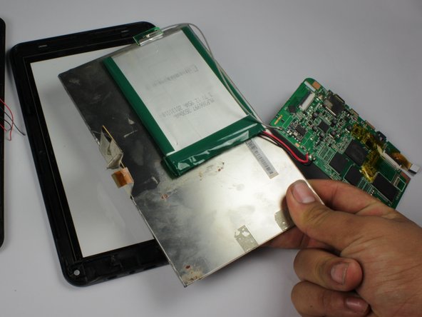

  7. Pioneer R1 LCD Display Replacement: crwdns2935265:07crwdnd2935265:01crwdnd2935265:01crwdne2935265:0
    • Slide a strong thin object, like a thin spudger, between the battery and the display.
    • Slide the object along the length of the battery to remove it from the display.
    • The adhesive holding the battery in place is strong and the battery is quite soft. Take care not to break open the battery.
  8. Pioneer R1 LCD Display Replacement: crwdns2935265:08crwdnd2935265:01crwdnd2935265:01crwdne2935265:0
    • Carefully pry off the component that is taped to the LCD display at the top of the R1.
