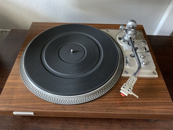

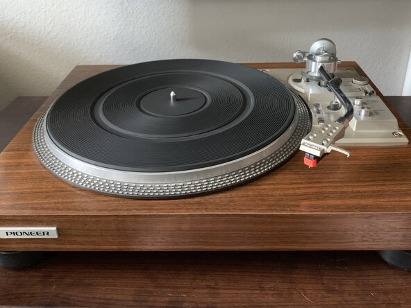

Pioneer PL-518 Turntable Needle Cartridge Replacement
  1. Pioneer PL-518 Turntable Needle Cartridge Replacement, Needle Cartridge: crwdns2935265:01crwdnd2935265:01crwdnd2935265:01crwdne2935265:0

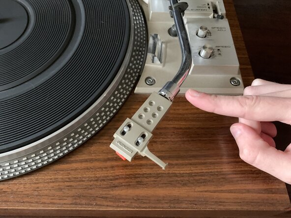

    • Ensure that the arm/tonearm is secured in its down position.

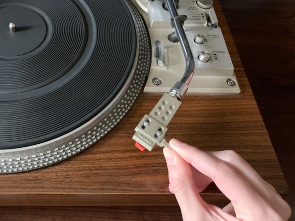

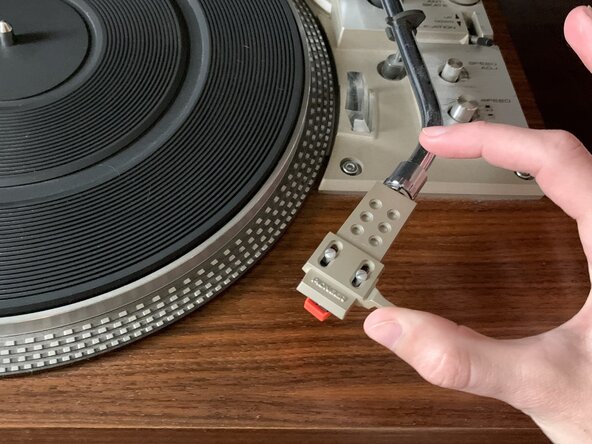

  2. Pioneer PL-518 Turntable Needle Cartridge Replacement: crwdns2935265:02crwdnd2935265:01crwdnd2935265:02crwdne2935265:0 Pioneer PL-518 Turntable Needle Cartridge Replacement: crwdns2935265:02crwdnd2935265:02crwdnd2935265:02crwdne2935265:0
    • Begin to rotate the joint counter-clockwise until you hear and feel a slight pop. This will release the joint’s hold on the cartridge.

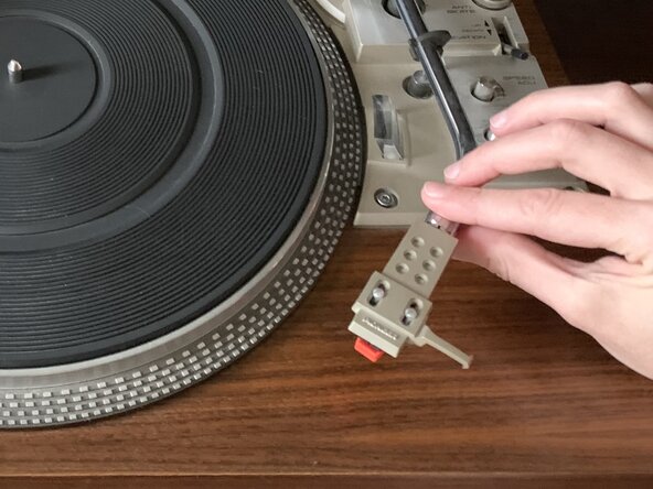

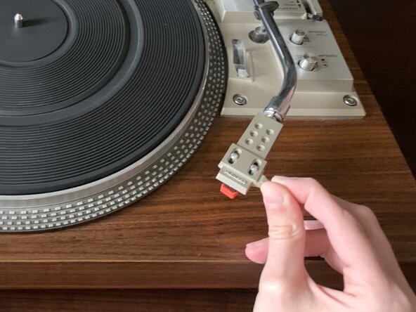

  3. Pioneer PL-518 Turntable Needle Cartridge Replacement: crwdns2935265:03crwdnd2935265:01crwdnd2935265:02crwdne2935265:0 Pioneer PL-518 Turntable Needle Cartridge Replacement: crwdns2935265:03crwdnd2935265:02crwdnd2935265:02crwdne2935265:0
    • Once the cartridge is loose, grab a hold of the stylus for a secure grip and pull the cartridge straight out from the joint. Set aside to recycle.

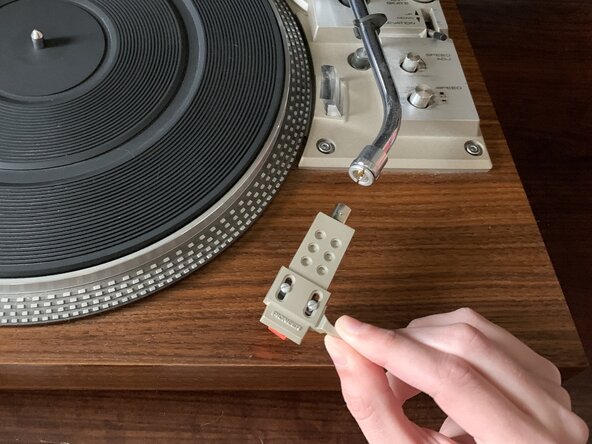

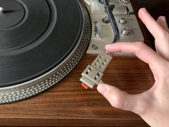

  4. Pioneer PL-518 Turntable Needle Cartridge Replacement: crwdns2935265:04crwdnd2935265:01crwdnd2935265:02crwdne2935265:0 Pioneer PL-518 Turntable Needle Cartridge Replacement: crwdns2935265:04crwdnd2935265:02crwdnd2935265:02crwdne2935265:0
    • Grab your replacement cartridge. Hold the cartridge by the stylus and line up the prongs with the logo facing up. Then, gently push the cartridge into the joint.

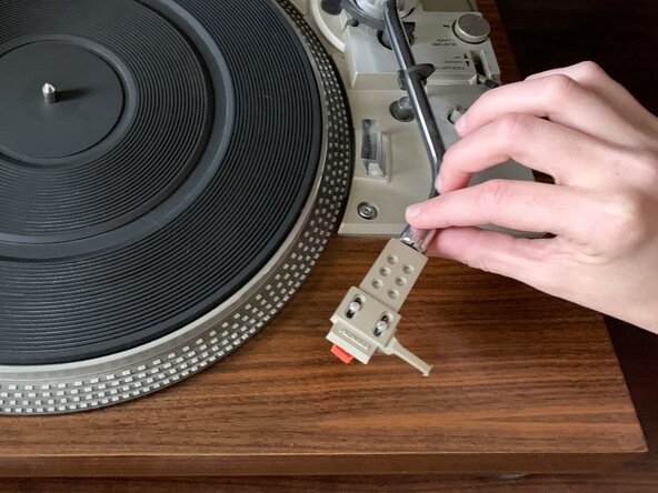

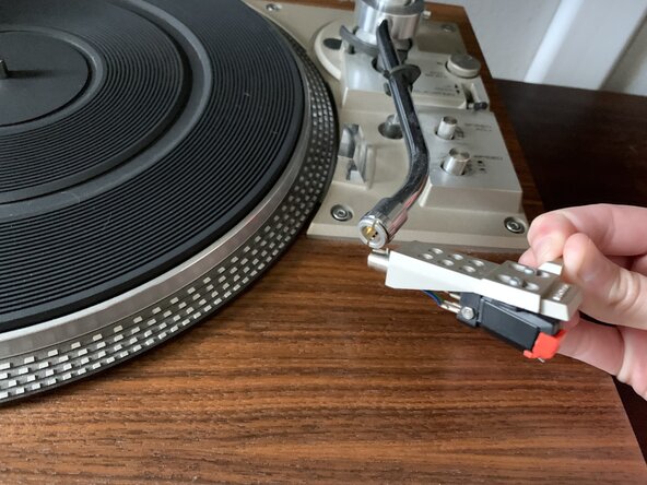

  5. Pioneer PL-518 Turntable Needle Cartridge Replacement: crwdns2935265:05crwdnd2935265:01crwdnd2935265:03crwdne2935265:0 Pioneer PL-518 Turntable Needle Cartridge Replacement: crwdns2935265:05crwdnd2935265:02crwdnd2935265:03crwdne2935265:0 Pioneer PL-518 Turntable Needle Cartridge Replacement: crwdns2935265:05crwdnd2935265:03crwdnd2935265:03crwdne2935265:0
    • Once the cartridge is in place, hold your cartridge by the stylus and push back lightly to attach.
    • Fasten the cartridge by rotating the joint clockwise with your fingers.
  6. Pioneer PL-518 Turntable Needle Cartridge Replacement: crwdns2935265:06crwdnd2935265:01crwdnd2935265:01crwdne2935265:0
    • Your turntable is now ready to use!
