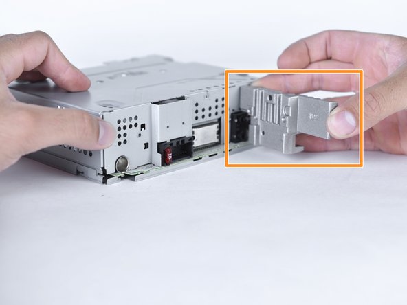

    • Remove the inner three 5mm Phillips head screws, with a Phillips #2 screwdriver, attached to the metal backing.
    • Remove the metal backing that is now free.
