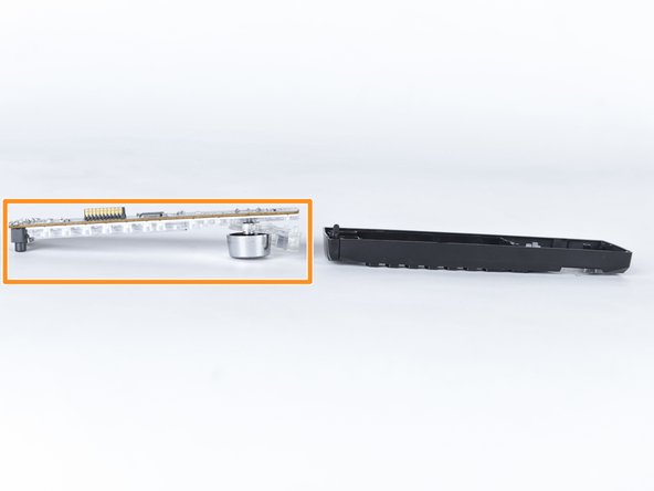

  4. Pioneer MXT-X366BT Knob Replacement: crwdns2935265:04crwdnd2935265:01crwdnd2935265:03crwdne2935265:0 Pioneer MXT-X366BT Knob Replacement: crwdns2935265:04crwdnd2935265:02crwdnd2935265:03crwdne2935265:0 Pioneer MXT-X366BT Knob Replacement: crwdns2935265:04crwdnd2935265:03crwdnd2935265:03crwdne2935265:0
    • Remove the back of the face plate.
    • Separate the motherboard from the casing.
    • Handle the motherboard with care.

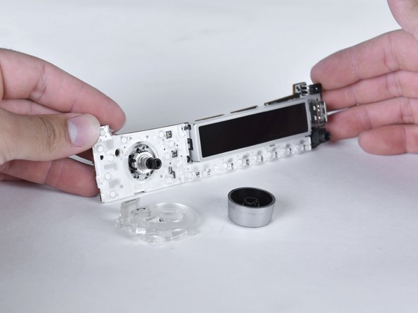

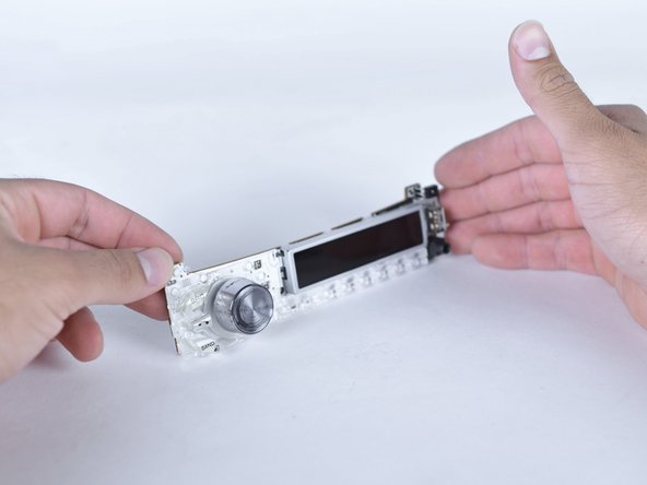

  5. Pioneer MXT-X366BT Knob Replacement: crwdns2935265:05crwdnd2935265:01crwdnd2935265:02crwdne2935265:0 Pioneer MXT-X366BT Knob Replacement: crwdns2935265:05crwdnd2935265:02crwdnd2935265:02crwdne2935265:0
    • Firmly pull the volume knob.
    • Carefully handle the motherboard to not break it.
    • Some force may be required to remove the knob.
    • Buttons are attached by a ring behind the volume knob.
