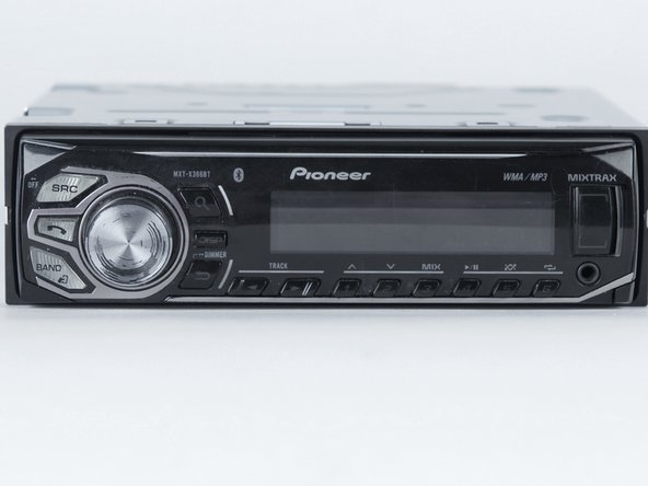

Pioneer MXT-X366BT Button Replacement
  1. Pioneer MXT-X366BT Button Replacement, Buttons: crwdns2935265:01crwdnd2935265:01crwdnd2935265:03crwdne2935265:0 Pioneer MXT-X366BT Button Replacement, Buttons: crwdns2935265:01crwdnd2935265:02crwdnd2935265:03crwdne2935265:0 Pioneer MXT-X366BT Button Replacement, Buttons: crwdns2935265:01crwdnd2935265:03crwdnd2935265:03crwdne2935265:0
    • Press the button on the bottom right hand corner firmly to release face plate.
    • Firmly pull out the face plate.
    • The face plate will now be free.

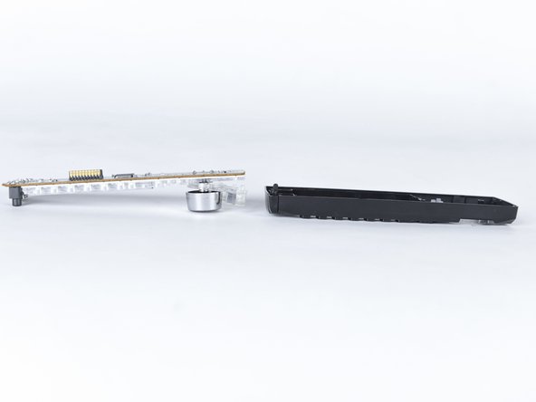

  2. Pioneer MXT-X366BT Button Replacement: crwdns2935265:02crwdnd2935265:01crwdnd2935265:01crwdne2935265:0
    • Use a Phillips #1 screwdriver to unscrew the three 3mm Phillips-head screws on the rear of the faceplate.
  3. Pioneer MXT-X366BT Button Replacement: crwdns2935265:03crwdnd2935265:01crwdnd2935265:01crwdne2935265:0
    • Press clips inward with the plastic opening tool to release the rear of the head unit.
  4. Pioneer MXT-X366BT Button Replacement: crwdns2935265:04crwdnd2935265:01crwdnd2935265:02crwdne2935265:0 Pioneer MXT-X366BT Button Replacement: crwdns2935265:04crwdnd2935265:02crwdnd2935265:02crwdne2935265:0
    • Remove the motherboard from the casing.
    • Handle the motherboard with care.
  5. Pioneer MXT-X366BT Button Replacement: crwdns2935265:05crwdnd2935265:01crwdnd2935265:02crwdne2935265:0 Pioneer MXT-X366BT Button Replacement: crwdns2935265:05crwdnd2935265:02crwdnd2935265:02crwdne2935265:0
    • Pull out the buttons.
    • Remember the orientation of the buttons.
