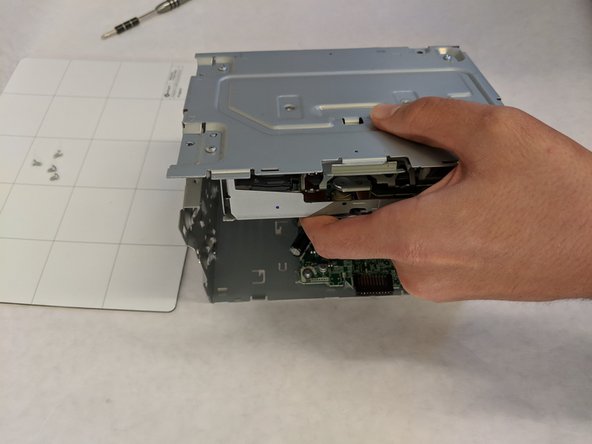

  3. Pioneer FH-X730BS Disk Drive Replacement: crwdns2935265:03crwdnd2935265:01crwdnd2935265:01crwdne2935265:0
    • Remove the ribbon wire from where it is being held in place. This can be done by applying force upwards.

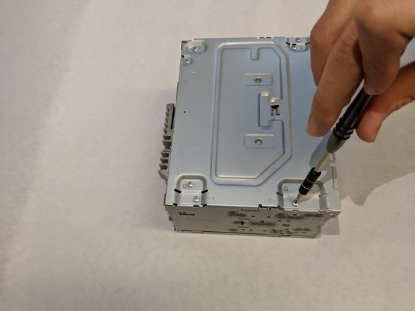

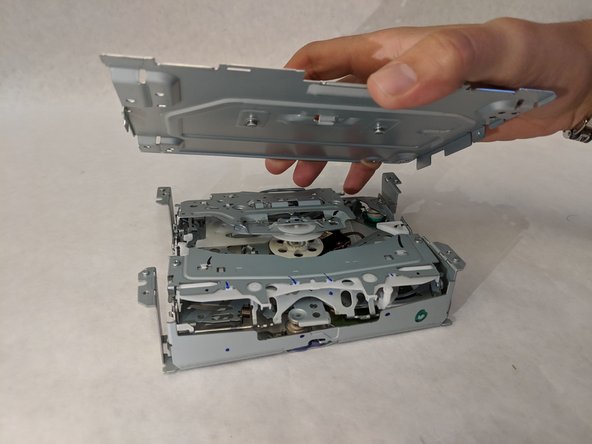

  4. Pioneer FH-X730BS Disk Drive Replacement: crwdns2935265:04crwdnd2935265:01crwdnd2935265:03crwdne2935265:0 Pioneer FH-X730BS Disk Drive Replacement: crwdns2935265:04crwdnd2935265:02crwdnd2935265:03crwdne2935265:0 Pioneer FH-X730BS Disk Drive Replacement: crwdns2935265:04crwdnd2935265:03crwdnd2935265:03crwdne2935265:0
    • Unscrew the four 7.3 mm outer screws on the top to remove the top face from the rest of the frame.

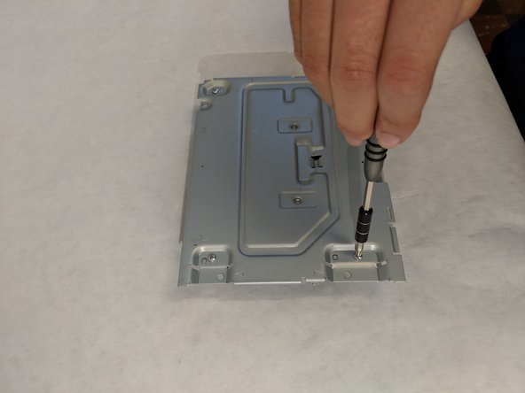

  5. Pioneer FH-X730BS Disk Drive Replacement: crwdns2935265:05crwdnd2935265:01crwdnd2935265:03crwdne2935265:0 Pioneer FH-X730BS Disk Drive Replacement: crwdns2935265:05crwdnd2935265:02crwdnd2935265:03crwdne2935265:0 Pioneer FH-X730BS Disk Drive Replacement: crwdns2935265:05crwdnd2935265:03crwdnd2935265:03crwdne2935265:0
    • Unscrew the four inner screws that are 7.3 mm long using a Phillips #1 head screw driver to remove the disk drive from the top face plate.
    • Replace the old disk drive with a new one.
