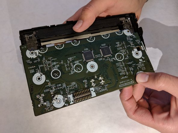

    • After removing the stereo face from the frame it should look similar to this.
    • Remove the seven 11.2mm Phillips #1 screws on the rear side of the stereo face.
  3. Pioneer FH-X730BS Auxiliary Inlet Replacement: crwdns2935265:03crwdnd2935265:01crwdnd2935265:03crwdne2935265:0 Pioneer FH-X730BS Auxiliary Inlet Replacement: crwdns2935265:03crwdnd2935265:02crwdnd2935265:03crwdne2935265:0 Pioneer FH-X730BS Auxiliary Inlet Replacement: crwdns2935265:03crwdnd2935265:03crwdnd2935265:03crwdne2935265:0

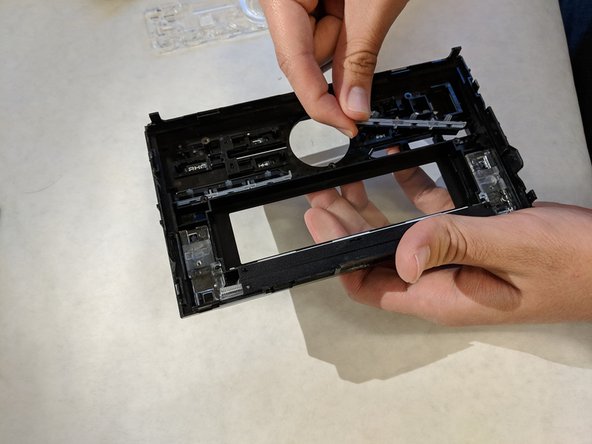

    • Remove the volume knob by pulling it towards you and pull the motherboard out of the face.
    • The audio buttons can now be taken out. You can flip the face downwards and tap the audio buttons.
    • You can now insert the replacement audio buttons into the face.
  4. Pioneer FH-X730BS Auxiliary Inlet Replacement, Auxiliary Inlet: crwdns2935265:04crwdnd2935265:01crwdnd2935265:01crwdne2935265:0
    • Here you are able to desolder the auxiliary ports from the circuit board and solder a replacement auxiliary port on.
    • The end of the soldering iron will be hot.
