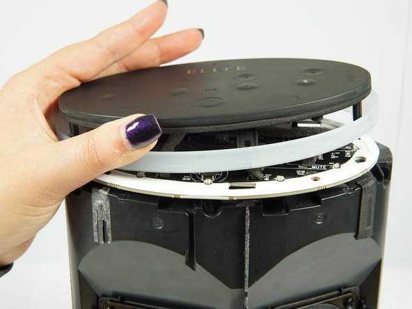

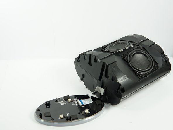

  9. Pioneer Elite Smart Speaker F4 LED Light Ring/Button Panel Replacement: crwdns2935265:09crwdnd2935265:01crwdnd2935265:02crwdne2935265:0 Pioneer Elite Smart Speaker F4 LED Light Ring/Button Panel Replacement: crwdns2935265:09crwdnd2935265:02crwdnd2935265:02crwdne2935265:0
    • Carefully remove the top panel, light ring, button panel, and the corresponding board.
    • Do not pull too hard, as there is a strip of wiring connected to the part below that could tear if pulled too hard or too far away.
  10. Pioneer Elite Smart Speaker F4 LED Light Ring/Button Panel Replacement, Button Panel Circuit Board: crwdns2935265:010crwdnd2935265:01crwdnd2935265:02crwdne2935265:0 Pioneer Elite Smart Speaker F4 LED Light Ring/Button Panel Replacement, Button Panel Circuit Board: crwdns2935265:010crwdnd2935265:02crwdnd2935265:02crwdne2935265:0
    • Lay the speaker down flat to make it easier to work on.
    • Remove the seven 4 mm screws with a Phillips #2 screwdriver.
  11. Pioneer Elite Smart Speaker F4 LED Light Ring/Button Panel Replacement: crwdns2935265:011crwdnd2935265:01crwdnd2935265:01crwdne2935265:0
    • Lift up the panel and remove it from the device.
    • Desoldering may be required to separate the circuit board completely. Please use our How to Solder and Desolder Connections Guide to properly and safely conduct this procedure.
