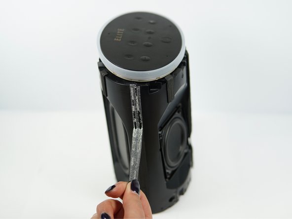

    • This step requires permanently damaging the casing of your device.
    • Turn the speaker counter-clockwise 90 degrees.
    • Use a knife to cut along the left seam all the way down the length of the device.
  7. Pioneer Elite Smart Speaker F4 I/O Port Replacement: crwdns2935265:07crwdnd2935265:01crwdnd2935265:02crwdne2935265:0 Pioneer Elite Smart Speaker F4 I/O Port Replacement: crwdns2935265:07crwdnd2935265:02crwdnd2935265:02crwdne2935265:0
    • The casing should be easily removed by prying and lifting it off.
    • If the casing gets caught on the back panel of plugs, use the metal spudger to lift the casing away from the panel, working all the way around. Pay special attention to the bottom, where it may be stuck with glue.

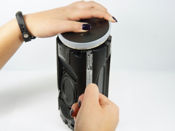

  10. Pioneer Elite Smart Speaker F4 I/O Port Replacement, Motherboard: crwdns2935265:010crwdnd2935265:01crwdnd2935265:03crwdne2935265:0 Pioneer Elite Smart Speaker F4 I/O Port Replacement, Motherboard: crwdns2935265:010crwdnd2935265:02crwdnd2935265:03crwdne2935265:0 Pioneer Elite Smart Speaker F4 I/O Port Replacement, Motherboard: crwdns2935265:010crwdnd2935265:03crwdnd2935265:03crwdne2935265:0
    • Peel off all rubber strips along sides, middle front and middle back of the device.

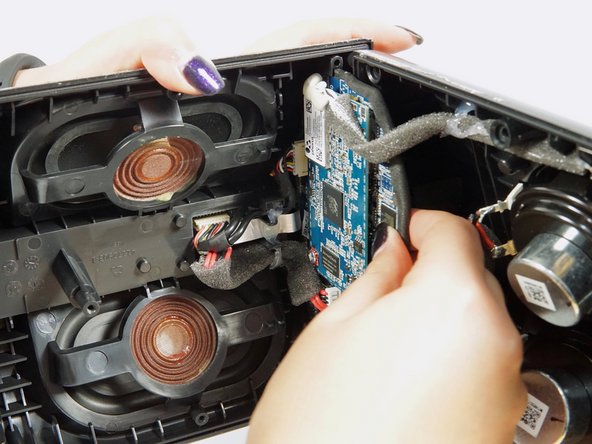

  12. Pioneer Elite Smart Speaker F4 I/O Port Replacement: crwdns2935265:012crwdnd2935265:01crwdnd2935265:01crwdne2935265:0
    • Pry apart the two sides carefully. The halves will not be able to separate completely because of wires and the motherboard.
  13. Pioneer Elite Smart Speaker F4 I/O Port Replacement: crwdns2935265:013crwdnd2935265:01crwdnd2935265:02crwdne2935265:0 Pioneer Elite Smart Speaker F4 I/O Port Replacement: crwdns2935265:013crwdnd2935265:02crwdnd2935265:02crwdne2935265:0
    • Slide the motherboard out using your hands.
  14. Pioneer Elite Smart Speaker F4 I/O Port Replacement: crwdns2935265:014crwdnd2935265:01crwdnd2935265:02crwdne2935265:0 Pioneer Elite Smart Speaker F4 I/O Port Replacement: crwdns2935265:014crwdnd2935265:02crwdnd2935265:02crwdne2935265:0
    • Slide out ribbon-like wire at the bottom of the speaker using your hands.

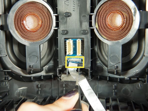

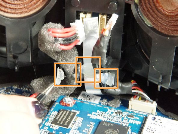

  15. Pioneer Elite Smart Speaker F4 I/O Port Replacement: crwdns2935265:015crwdnd2935265:01crwdnd2935265:01crwdne2935265:0
    • Remove two of the wire connectors with your hands or with tweezers.
  16. Pioneer Elite Smart Speaker F4 I/O Port Replacement: crwdns2935265:016crwdnd2935265:01crwdnd2935265:03crwdne2935265:0 Pioneer Elite Smart Speaker F4 I/O Port Replacement: crwdns2935265:016crwdnd2935265:02crwdnd2935265:03crwdne2935265:0 Pioneer Elite Smart Speaker F4 I/O Port Replacement: crwdns2935265:016crwdnd2935265:03crwdnd2935265:03crwdne2935265:0
    • Remove the two wire connectors using tweezers or your fingers. Be careful not to damage the plastic.
    • Remove the 3 pieces of hot glue using tweezers. Don't worry about ripping the foam covering the cords.
    • Remove the ribbon wire by pulling on it with tweezers.
    • Removing this may permanently damage the connector.

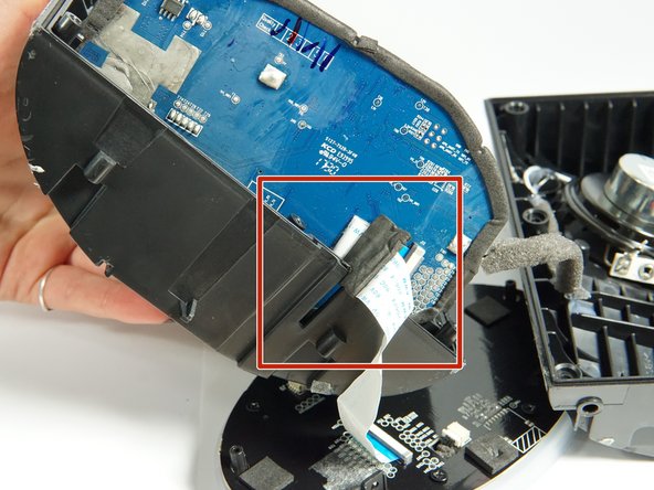

  17. Pioneer Elite Smart Speaker F4 I/O Port Replacement: crwdns2935265:017crwdnd2935265:01crwdnd2935265:01crwdne2935265:0
    • Peel away the off white glue and disconnect the wires from the motherboard.
    • Remove the motherboard from the device.
    • Disconnecting the wires from the motherboard may require desoldering them.

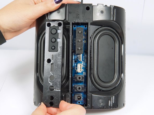

  18. Pioneer Elite Smart Speaker F4 I/O Port Replacement, I/O Port: crwdns2935265:018crwdnd2935265:01crwdnd2935265:01crwdne2935265:0
    • Using the metal spudger, peel the backing off of the back panel of the speaker to reveal 4 screw holes.
  19. Pioneer Elite Smart Speaker F4 I/O Port Replacement: crwdns2935265:019crwdnd2935265:01crwdnd2935265:02crwdne2935265:0 Pioneer Elite Smart Speaker F4 I/O Port Replacement: crwdns2935265:019crwdnd2935265:02crwdnd2935265:02crwdne2935265:0
    • Remove the four 4 mm screws with a Phillips #2 screwdriver, then lift off the panel.

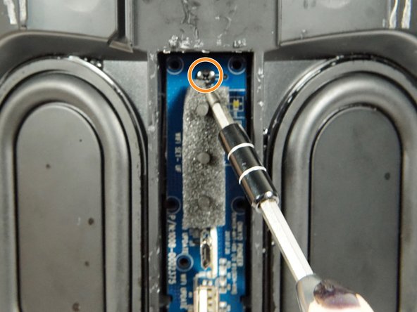

  20. Pioneer Elite Smart Speaker F4 I/O Port Replacement: crwdns2935265:020crwdnd2935265:01crwdnd2935265:02crwdne2935265:0 Pioneer Elite Smart Speaker F4 I/O Port Replacement: crwdns2935265:020crwdnd2935265:02crwdnd2935265:02crwdne2935265:0
    • Remove the two 4 mm screws with a Phillips #1 screwdriver.
    • Pull back on the top of the grey foam rectangle to reveal another screw. Remove the one 4 mm screw with a Phillips #1 screwdriver.
  21. Pioneer Elite Smart Speaker F4 I/O Port Replacement: crwdns2935265:021crwdnd2935265:01crwdnd2935265:01crwdne2935265:0
    • Once the screws are removed, remove the panel with your hands.
