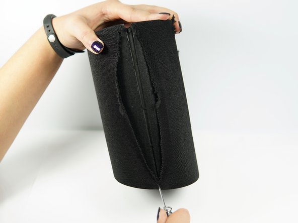

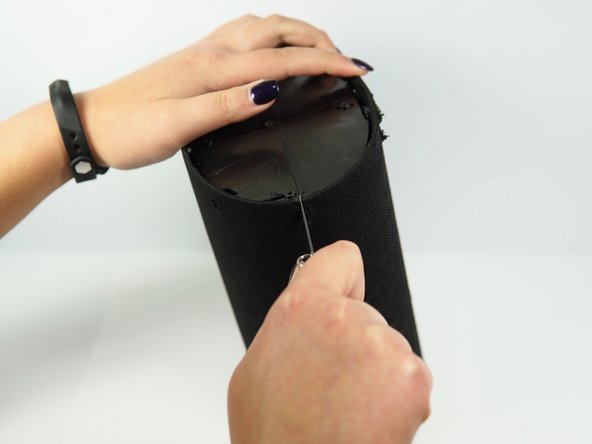

  6. Pioneer Elite Smart Speaker F4 Fabric Casing: crwdns2935265:06crwdnd2935265:01crwdnd2935265:03crwdne2935265:0 Pioneer Elite Smart Speaker F4 Fabric Casing: crwdns2935265:06crwdnd2935265:02crwdnd2935265:03crwdne2935265:0 Pioneer Elite Smart Speaker F4 Fabric Casing: crwdns2935265:06crwdnd2935265:03crwdnd2935265:03crwdne2935265:0
    • This step requires permanently damaging the casing of your device.
    • Turn the speaker counter-clockwise 90 degrees.
    • Use a knife to cut along the left seam all the way down the length of the device.

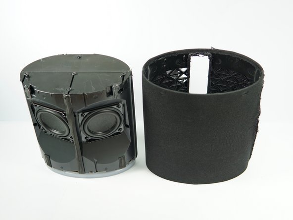

  7. Pioneer Elite Smart Speaker F4 Fabric Casing: crwdns2935265:07crwdnd2935265:01crwdnd2935265:02crwdne2935265:0 Pioneer Elite Smart Speaker F4 Fabric Casing: crwdns2935265:07crwdnd2935265:02crwdnd2935265:02crwdne2935265:0
    • The casing should be easily removed by prying and lifting it off.
    • If the casing gets caught on the back panel of plugs, use the metal spudger to lift the casing away from the panel, working all the way around. Pay special attention to the bottom, where it may be stuck with glue.

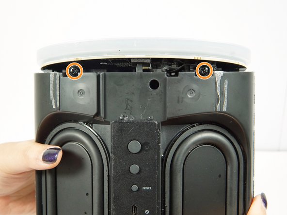

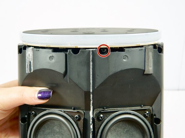

  8. Pioneer Elite Smart Speaker F4 Fabric Casing: crwdns2935265:08crwdnd2935265:01crwdnd2935265:03crwdne2935265:0 Pioneer Elite Smart Speaker F4 Fabric Casing: crwdns2935265:08crwdnd2935265:02crwdnd2935265:03crwdne2935265:0 Pioneer Elite Smart Speaker F4 Fabric Casing: crwdns2935265:08crwdnd2935265:03crwdnd2935265:03crwdne2935265:0
    • Flip device 180 degrees so the light ring/button panel is on top with the 'Elite' facing you.
    • Remove one 6 mm screw with a Phillips #2 screwdriver.
    • Spin the device so the opposite side is facing you.
    • Remove the two 6 mm screws with a Phillips #2 screwdriver.

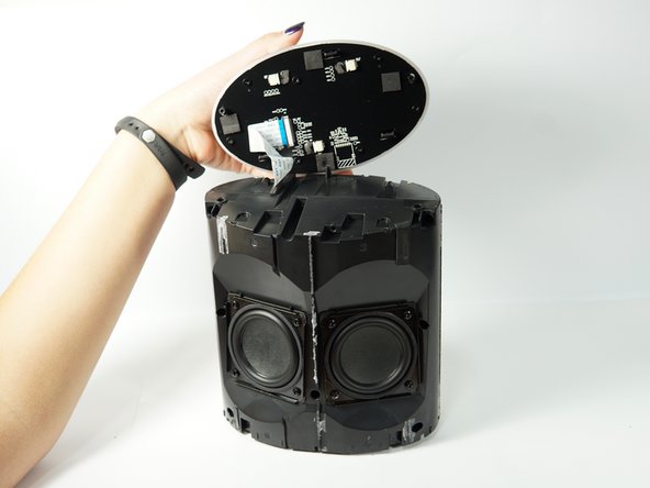

  9. Pioneer Elite Smart Speaker F4 Fabric Casing: crwdns2935265:09crwdnd2935265:01crwdnd2935265:02crwdne2935265:0 Pioneer Elite Smart Speaker F4 Fabric Casing: crwdns2935265:09crwdnd2935265:02crwdnd2935265:02crwdne2935265:0
    • Carefully remove the top panel, light ring, button panel, and the corresponding board.
    • Do not pull too hard, as there is a strip of wiring connected to the part below that could tear if pulled too hard or too far away.
