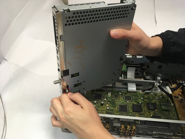

    • Remove the two 6.4 mm Phillips screws on each side of the device's casing.
  2. Pioneer Elite PRO-RO6U Motherboard Replacement: crwdns2935265:02crwdnd2935265:01crwdnd2935265:01crwdne2935265:0
    • Remove the two 6.5 mm Phillips screws on the back of the device casing.
  3. Pioneer Elite PRO-RO6U Motherboard Replacement: crwdns2935265:03crwdnd2935265:01crwdnd2935265:01crwdne2935265:0
    • Grip the front panel in one hand and the back of the casing in the other. Pull the casing back, and slide it up and away from the inner box.

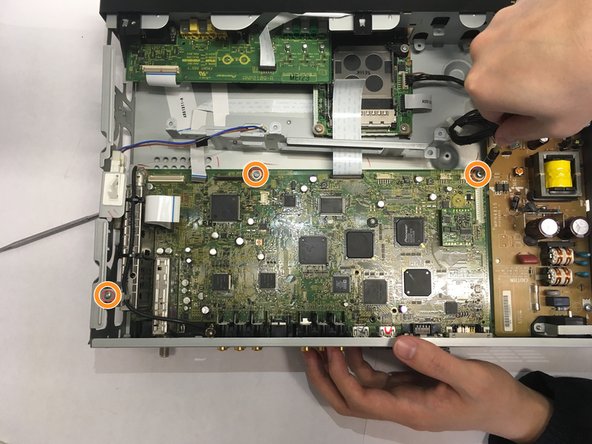

  14. Pioneer Elite PRO-RO6U Motherboard Replacement: crwdns2935265:014crwdnd2935265:01crwdnd2935265:02crwdne2935265:0 Pioneer Elite PRO-RO6U Motherboard Replacement: crwdns2935265:014crwdnd2935265:02crwdnd2935265:02crwdne2935265:0
    • Unplug connectors at M1, M4, M7, M8, M9 by gently pulling upward.
    • Remove all 3/8 inch Phillips screws connecting motherboard to casing.
  15. Pioneer Elite PRO-RO6U Motherboard Replacement: crwdns2935265:015crwdnd2935265:01crwdnd2935265:01crwdne2935265:0
    • Remove the five 1/4 inch Phillips screws and two 1/8 inch Phillips screws on the back of the casing.
    • Unscrew and remove nut from threaded connector.
  16. Pioneer Elite PRO-RO6U Motherboard Replacement: crwdns2935265:016crwdnd2935265:01crwdnd2935265:01crwdne2935265:0
    • Remove four 1/2 inch screws using a nutdriver.
  17. Pioneer Elite PRO-RO6U Motherboard Replacement: crwdns2935265:017crwdnd2935265:01crwdnd2935265:01crwdne2935265:0
    • Pinch the securing tabs and lift the motherboard toward the interior of the device to remove it.
  18. Pioneer Elite PRO-RO6U Motherboard Replacement: crwdns2935265:018crwdnd2935265:01crwdnd2935265:01crwdne2935265:0
    • Pull it toward the interior of the device and lift it away.
