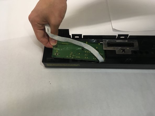

  6. Pioneer Elite PRO-RO6U Control Panel Circuit Board Replacement: crwdns2935265:06crwdnd2935265:01crwdnd2935265:01crwdne2935265:0
    • Grip and unplug the ribbon connector that connects the front circuit board to the device.
  7. Pioneer Elite PRO-RO6U Control Panel Circuit Board Replacement: crwdns2935265:07crwdnd2935265:01crwdnd2935265:01crwdne2935265:0
    • Unscrew the three 1/4 Phillips head screws on the back of the front circuit board.
  8. Pioneer Elite PRO-RO6U Control Panel Circuit Board Replacement: crwdns2935265:08crwdnd2935265:01crwdnd2935265:02crwdne2935265:0 Pioneer Elite PRO-RO6U Control Panel Circuit Board Replacement: crwdns2935265:08crwdnd2935265:02crwdnd2935265:02crwdne2935265:0
    • Grip the circuit board and slide towards the front side of the plastic casing.
    • Lift upwards to remove the circuit board from the front panel.
